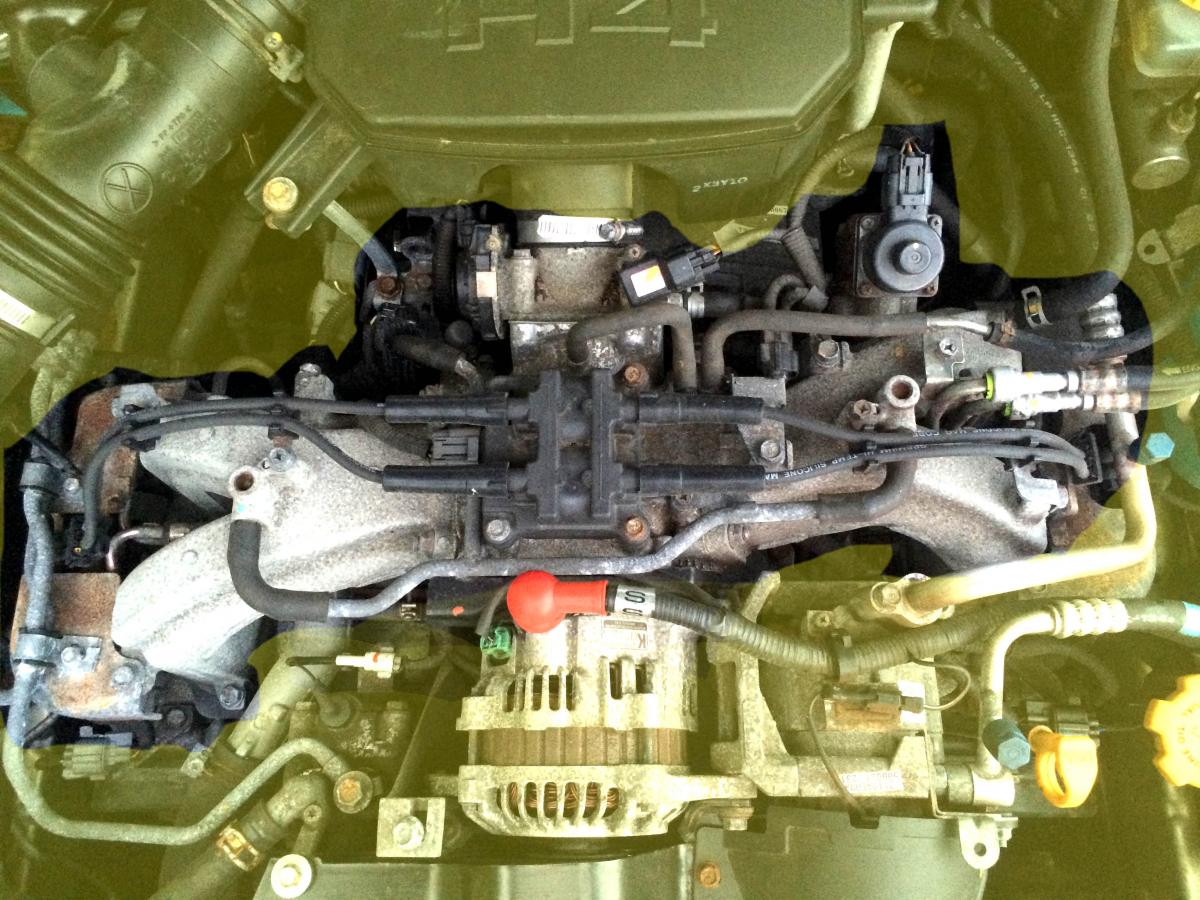

John-s Posted May 18, 2015 Share Posted May 18, 2015 Old thread I realize. I just want to correct a bit of info. I have a 2004 OBW EJ259 engine with drive by wire. So late 2004 OBW Limited, California spec cars have DBW. These cars are also sold new in New York State like mine was. John Link to comment Share on other sites More sharing options...
