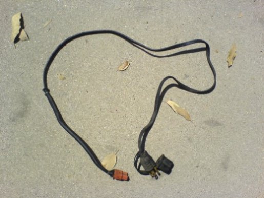

Sonicfrog Posted April 25, 2007 Share Posted April 25, 2007 Yes, the large end is a standard plug for a 120 volt wall socket you would find in your livingroom. It was on my old, dead EJ22. One end was at the bottom of the oil dipstic tube, the other by the flywheel window at the top of the tranny. I took it off last November and don't remember if it was connected to anything. Link to comment Share on other sites More sharing options...
idosubaru Posted April 25, 2007 Share Posted April 25, 2007 that's the limited production electrically assisted prototype EJ22. for real. it's probably an engine block heater or a mechanism for charging the battery. Link to comment Share on other sites More sharing options...
Gnuman Posted April 25, 2007 Share Posted April 25, 2007 It is the power cord to your installed block heater. I have one too. If you are in a particularly cold climate, plugging that into 120VAC at night will keep teh coolant from freezing, which would damage your engine. That block heater is also part of the "cold weather package". Link to comment Share on other sites More sharing options...
Sonicfrog Posted April 25, 2007 Author Share Posted April 25, 2007 Where is the heating device located at? Since I installed a different engine do I have to remove the heater from the old one???? Link to comment Share on other sites More sharing options...
nipper Posted April 25, 2007 Share Posted April 25, 2007 Sonicfrog said: Where is the heating device located at? Since I installed a different engine do I have to remove the heater from the old one???? It came with the cold weather package, If you have never used it before, you dont need to reinstall it. nipper PS unless you got the 20 mile extension cord option. Ever wonder why the spare tire well is so big? hehehehe Link to comment Share on other sites More sharing options...
Sonicfrog Posted April 26, 2007 Author Share Posted April 26, 2007 I found the heater thingy. It's underneath the engine, between the driver side exhaust and the oil pan. It screws into the block. I'll take a pic tomorrow. Link to comment Share on other sites More sharing options...
Andyjo Posted April 26, 2007 Share Posted April 26, 2007 ahhh the wonders of the engine block heater i wouldn't try to take that out if i were you... because to get it in there in the 1st place is a pain in the arse (as per the original coolant plug not coming out.) if you plan on using it, you may want to clean out the contacts on the plug part (attached to the motor), and then plug it in, and rout the wire up through, and never un-plug it again... so you don't get crap built up in the connection. Block heaters are awesome for arctic weather, and your car will thank you for it Link to comment Share on other sites More sharing options...
