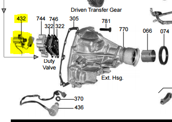

fsalgado Posted September 1, 2015 Share Posted September 1, 2015 I have a Legacy GT 2.5 L 1997. So I think this one describes my trans. Question, on the on line stores I have two options for the solenoid, one is just the solenoid and other is the solenoid attached to a small metallic piece that sits on the case (I think that is the duty valve). I'm thinking I just need the solenoid (that of course is cheaper). What do you recommends? Look at the illustration, is the highlighted. Thanks! Link to comment Share on other sites More sharing options...
CNY_Dave Posted September 1, 2015 Share Posted September 1, 2015 Just the solenoid. Link to comment Share on other sites More sharing options...
