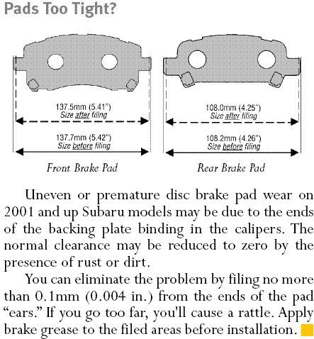

Petersubaru Posted August 2, 2007 Share Posted August 2, 2007 when I purchased my 01 outback last nov. I took the car to our subaru dealer in town here for an inspection..although the brakes were completely new (Rotor and Pads on all 4) the mechanic remarked to me that all was fine in his opinion except the new brakes..he said with most aftermarket installations and also some subaru places are not aware of the proper way to install the pads, to keep them from binding up,when the caliper has been released,...when rotateing the tires he felt that there was to much drag, and although borderline in his opinion, we left the situation as a "wait and see"...2000mi later for another inspection on all 4 wheels, now the inside of the disc was showing abnormal wear, in otherwords the disc was not remaining clean and becoming somewhat rusty in places..the cure for this was to remove 1-1.5mm from the length of the pad so that the pad moves more freely "within" the anti-rattle clips...I should have known better myself because it was a common problem for my 85 vw and 93 pontiac..several thousand miles later all is fine now..don't forget to use the synthetic grease between the shim and pad and on top of the pad and of course the anti-rattle/slider area Link to comment Share on other sites More sharing options...
porcupine73 Posted August 2, 2007 Share Posted August 2, 2007 There was a note in endwrench about that. Link to comment Share on other sites More sharing options...
SVX_commuter Posted August 2, 2007 Author Share Posted August 2, 2007 Petersubaru said: when I purchased my 01 outback last nov. ....................the cure for this was to remove 1-1.5mm from the length of the pad so that the pad moves more freely "within" the anti-rattle clips... This is what I have been thinking. The pads fit too tight in the calipher springs and cannot slide properly. The AA pads have been real bad in this regard. Even the Suby pads are hanging up pretty good. They will require belt sander to get them to move better. Why is the "size quality" so poor on these pads? This kind of metal removal should not be required. The pads should drop right in there and move freely. Thanks Link to comment Share on other sites More sharing options...
Petersubaru Posted August 2, 2007 Share Posted August 2, 2007 porcupine73 said: There was a note in endwrench about that. "That'ill teach ya for takeing the car somewhere else"... or in otherwords..this must be subarus' way of punishing those who take there car for brake service to a non-dealer/ un-informed dealer/ mechanic or the DIY Link to comment Share on other sites More sharing options...
