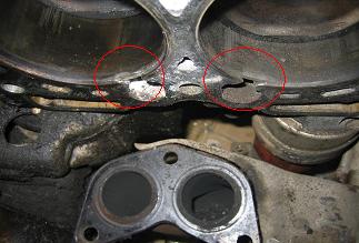

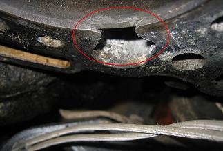

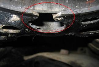

SoobGoob Posted August 11, 2007 Author Share Posted August 11, 2007 well its a 91 i dont belive they had open deck blocks then did they? even the NA here are the pics. tell it to me straight doc Quote Link to comment Share on other sites More sharing options...
86BRATMAN Posted August 11, 2007 Share Posted August 11, 2007 Nope, n/a ej22's are all open deck. You can stick one in there, but I would recommend at least putting a set off ej22t pistons in there. They can hold about 300 hp with those pistons and the right tune. Best illustration of block difference that I know of. http://legacycentral.org/library/literature/deck.htm Quote Link to comment Share on other sites More sharing options...
idosubaru Posted August 11, 2007 Share Posted August 11, 2007 wowsers, that block blew up huh? did it run like that? what caused it? overheating, blown turbo, detonation? Quote Link to comment Share on other sites More sharing options...
SoobGoob Posted August 11, 2007 Author Share Posted August 11, 2007 blown turbo+overheating= that mess. what if i got a open deck 2.5 block? would that work? Quote Link to comment Share on other sites More sharing options...
