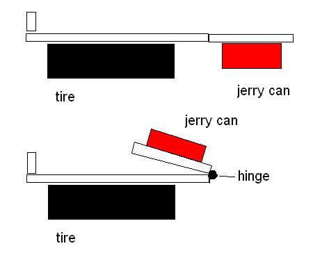

s'ko Posted September 12, 2007 Share Posted September 12, 2007 I am in the process of making a spare tire holder with a 5 gal jerry can next to it. I plan to mount it to the driver side rear bumper and have it swing out to clear the tailgate when it is lowered. I put a 5 gal jerry can next to it so when it swings out it's about 3 feet long. I feel that this is kinda long so I have two ideas. Should I put a hinge on it so that the jerry can can swing behind the tire when it is open all the way. The main concern there is that the holder needs to swing real wide so that the tail gate can be opened b/c of the added width of the jerry can. Or should I make a seperate holder for the jerry can and make them barn door style. Then I could put on the jerry can when needed and remove it when it's not being used. Link to comment Share on other sites More sharing options...
mcbrat Posted September 12, 2007 Share Posted September 12, 2007 I like the hinge idea. Link to comment Share on other sites More sharing options...
nipper Posted September 12, 2007 Share Posted September 12, 2007 36" really is not that long for a jerry can/spare tire holder. Ive seen longer. Give more thought as to how to mount the thing and keep it latched. nipper Link to comment Share on other sites More sharing options...
