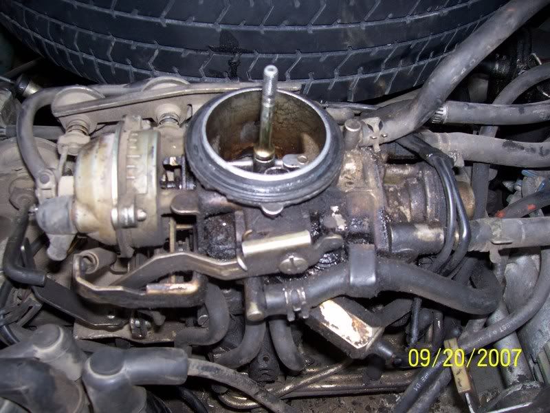

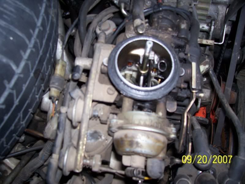

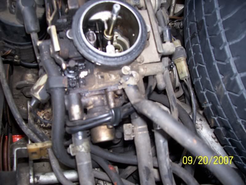

spokanesoob Posted September 21, 2007 Share Posted September 21, 2007 Its the name that carburator game its so addicting trouble is i get mad when i cant figure it out! yea! so whats this carburator mabey some one with a little more experence on this matter could be loads of help. Its on a 87 hatch but i dont think its the origanal ea 81 or carb but im not sure so heres some pics! http://i65.photobucket.com/albums/h229/lowjt/Jordan007.jpg http://i65.photobucket.com/albums/h229/lowjt/Jordan006.jpg http://i65.photobucket.com/albums/h229/lowjt/Jordan005.jpg there hope this works and thanks ahead of time ! spokanesoob Link to comment Share on other sites More sharing options...

spokanesoob Posted September 21, 2007 Author Share Posted September 21, 2007 yea i dont know either how can you tell the diffrence i guess is what im asking is there somewhere on the carb that says it? i look good and hard but i could be blind you never know. Link to comment Share on other sites More sharing options...
Durania Posted September 21, 2007 Share Posted September 21, 2007 Hitachi, from the vacuum line mess coming off from it. This is what a Weber looks like: Link to comment Share on other sites More sharing options...
LPGsuperchargedBrumby Posted September 21, 2007 Share Posted September 21, 2007 its a hitachi dude,looks the same as the one in my aussie brumby Link to comment Share on other sites More sharing options...
subaruguru Posted September 21, 2007 Share Posted September 21, 2007 crapachi ROUND weber SQUARE that should help weber has more of a square mouth on it with square butterflys. the hitachi has around mouth and you only have one butterfly in the top for the choke. am i right correct me if im wrong. Link to comment Share on other sites More sharing options...

j2coe Posted September 21, 2007 Share Posted September 21, 2007 components match the diagram of a hitachi. I don't have anything carbed anymore but back when I did I thought they had the weber name or the hitachi symbol stamped on the side of the body didn't they? of course you usually had to clean a lot of gunk to see it Link to comment Share on other sites More sharing options...

Caboobaroo Posted September 22, 2007 Share Posted September 22, 2007 crapachi ROUND weber SQUARE that should help weber has more of a square mouth on it with square butterflys. the hitachi has around mouth and you only have one butterfly in the top for the choke. am i right correct me if im wrong. Might wanna rethink that bucko... Hitachi it is since its a 2 barrel round mouth carb. If it was a single barrel round mouth, it would be a Carter-Weber which, unless you know how they work, can be more hassle then a Hitachi. Now there are people running the Weber (either a 28/32 or a 32/36 on here) or its look alike Holley 5200 which was made by Weber but has smaller barrels (GD and I discovered this after I bought one and compared) but it works better then a 32/36 when put onto an EA71. Link to comment Share on other sites More sharing options...
GeneralDisorder Posted September 22, 2007 Share Posted September 22, 2007 That's a Hitachi - looks bone stock for an 87 Hatch. Should be a DCP-308 variant (30/28). Carter-Weber's are single barrel and are completely unlike the one pictured. Weber's (DGV, DFV, Holley 5200) are aftermarket only. GD Link to comment Share on other sites More sharing options...

Flowmastered87GL Posted September 23, 2007 Share Posted September 23, 2007 the choke and the opening at the top of the carb both look like hitachi to me as well. I think a carter-weber is backwards from that and has different components. Link to comment Share on other sites More sharing options...

Caboobaroo Posted September 23, 2007 Share Posted September 23, 2007 the choke and the opening at the top of the carb both look like hitachi to me as well. I think a carter-weber is backwards from that and has different components. yes Mike but with the theory "round is Hitachi and square is Weber" is too vague especially when someone comes on here looking to see what kind of carb they have. Which is why I mentioned the Carter-Weber having a round barrel on it. PIR... Portland International Raceway Link to comment Share on other sites More sharing options...
