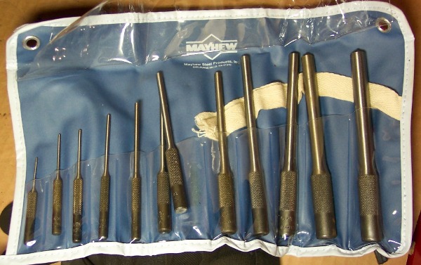

porcupine73 Posted September 25, 2007 Share Posted September 25, 2007 Hi. IIRC you drive the pin out from the non-beveled side and drive it in from the beveled side. I put some penetrating oil on the pin before trying to drive it out. It took a bit of force to get it to come out. I used this pin punch, but I forget what size it was (edit: I think it is 7/32", not sure): What I hear is you definitely do not want to use too small of a punch as it can mushroom the roll pin head and jam it firmly in place so it won't come out, and possibly jam the pin punch in the hole as well. From this pin punch set (just saw one of these for not too much on eBay; auction might still be on): This is how I drove it out since like you said access is limited. I pounded on the top of the end of the socket extensions, inside of which was the pin punch: New oem roll pin/spring pin: Link to comment Share on other sites More sharing options...
JT95 Posted September 25, 2007 Author Share Posted September 25, 2007 Dude--awsome response--thanks so much! Now, why the heck couldn't Haynes have made it that clear in their manual? I just kicked myself for not thinking to stick the punch in a socket and extension--geez--that shoulda been a non-brainer... Link to comment Share on other sites More sharing options...
