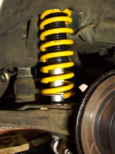

porcupine73 Posted September 27, 2007 Share Posted September 27, 2007 Hi ScottD and to the board! If the rear suspension is the regular mcpherson type, then eccentric camber bolts such as the ones below (typically by putting one in the top mounting hole, or if that doesn't get enough adjustment, one in the top and one in the bottom for the two bolts holding the strut to the bearing housing.) However if the Baja has the independent link or whatever they call it rear suspension, (such as this pic of my '00 outback), the camber bolts will not work because the strut does not mount to the bearing housing with two bolts like the regular mcpherson style. Eccentric camber bolt is in the top hole (this is front of '00 obw): Quote Link to comment Share on other sites More sharing options...

ScottD Posted September 29, 2007 Author Share Posted September 29, 2007 porcupine, Thanks for the suggestion. MY rear struts are not mcpherson style like the front ones. However I will try some OEM bolts, I noticed that some seem to provide more adjustment than others. thanks again Quote Link to comment Share on other sites More sharing options...
