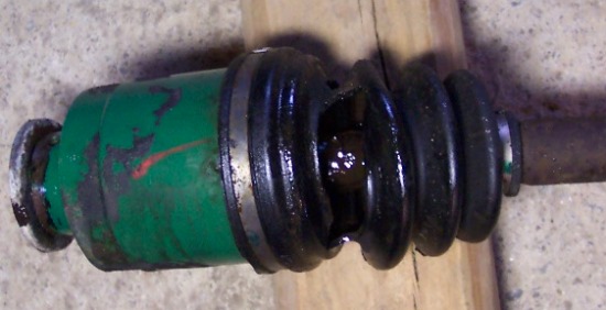

1995SubaruImpreza Posted October 4, 2007 Author Share Posted October 4, 2007 porcupine73 said: haha yah that is funny. Can you take a peak at the boots to see if they really are split? Sometimes as the boots age they develop a lot of little cracks in the rubber but aren't yet split; not sure if that's what they're seeing or what. I mean this is what a split boot looks like: Sorry I just noticed you are from buffalo NY, I go there often shopping lol Do you know of any good mechanics in that area...I have been thinking about taking it in in the states for a while because everything just seems cheaper there and people generally know what a Subaru is there Link to comment Share on other sites More sharing options...

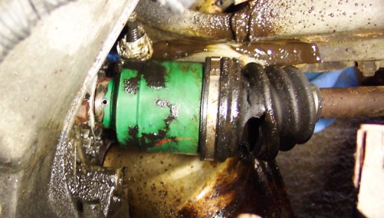

Cubby Posted October 5, 2007 Share Posted October 5, 2007 My inner passenger CV boot split about a month ago. I notived a burning smell coming from the engine when I stopped and noticed grease spewd all over the engine and exhaust. What a smell. Link to comment Share on other sites More sharing options...
jon38iowa Posted October 5, 2007 Share Posted October 5, 2007 Cubby said: My inner passenger CV boot split about a month ago. I motived a burning smell coming from the engine when I stopped and noticed grease spewd all over the engine and exhaust. What a smell. Indeed! Thats how I discovered mine had torn. The smell is horrible if not down right putrid. Link to comment Share on other sites More sharing options...
porcupine73 Posted October 5, 2007 Share Posted October 5, 2007 Yes that is a nasty acrid smell. When mine ripped, I was at a gas station and I smelled it and I thought a truck tire was on fire or something. Then when I stopped at Home Despot I smelled it again and thought that can't be good, and people walking in front of my car were making sickly faces and wafting their hands in front of their noses. Link to comment Share on other sites More sharing options...
2X2KOB Posted October 5, 2007 Share Posted October 5, 2007 I just did mine, a 2000 OBW. Both inners failed within about a week of each other, and the vile stench was the clue to look underneath. I replaced the axle shafts with new ones from MWE, which were $75 each plus shipping. A pretty good deal. Mileage is about 148,000. Link to comment Share on other sites More sharing options...
