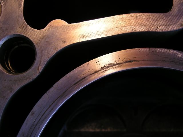

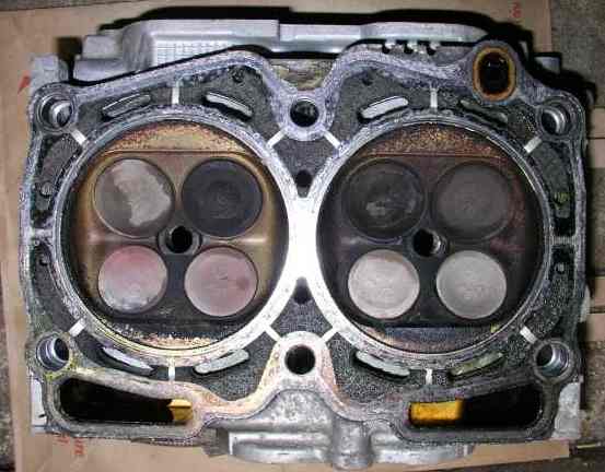

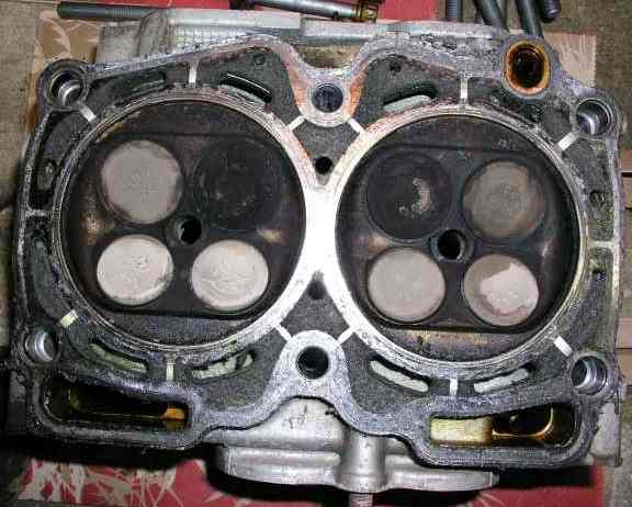

sublute Posted October 18, 2007 Author Share Posted October 18, 2007 I would like your opinions. From my reading about head gaskets and seeing some photos on this board, it looks like the leak was on cyl 1?? Let me know what you think. thanks Link to comment Share on other sites More sharing options...
mnwolftrack Posted October 18, 2007 Share Posted October 18, 2007 It might just be my screen, but I can't really tell from the photos. The typical place that the headgaskets fail is on the lowest point of the cylinders into the two small water ports. These water ports would make the "smile" of a smiley face if they connected, and the two lowest valves would make the "eyes" of the smiley face (if that makes any sense). On mine, the failure was on the passenger rear cylinder, and a little bit on the front cylinder. The driver side was fine. There was black carbon on both the head and the block going through the area of the metal fire ring and extending all the way to the 2 water ports. If you leave your cylinder heads intact as-is and bring the old gaskets in, the machine shop can probably point you to the failure point(s). Link to comment Share on other sites More sharing options...

sublute Posted October 18, 2007 Author Share Posted October 18, 2007 After I took the gasket off the head, I could see the slight carbon tracing from the cylinder to the coolant passage on cylinder #1. I put my ground straight edge on it and it looked pretty good. I'll see what the machinist has to say. I put my order into 1stSubaruParts which came to $400!!! I decided to replace the lower idlers which were noisy, so I guess that really tipped the scale... I guess it's not bad since I had the car given to me. They did say I didn't need the O-rings for the cross over pipe. Link to comment Share on other sites More sharing options...

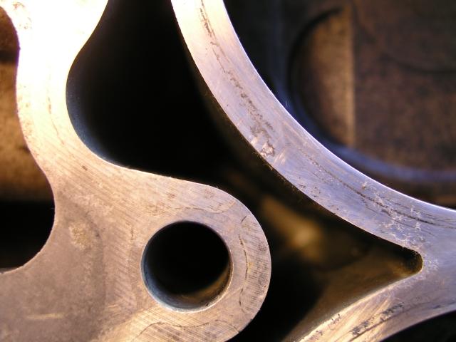

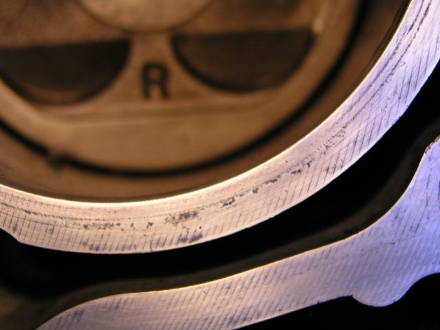

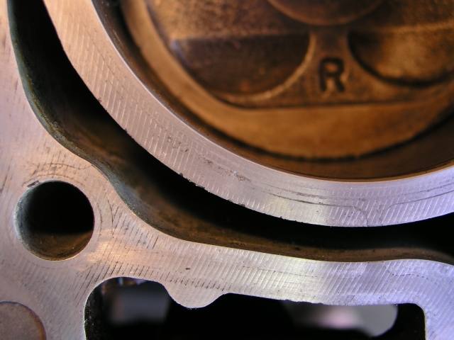

sublute Posted October 31, 2007 Author Share Posted October 31, 2007 Hello, I've been reading about the MLS gaskets and their needing almost mirror surface? Then, other opinions in threads mention gaskets needing something to "bite" on. Here are some photos of the engine block that I'm preparing. Do the corroded area's need to be cleaned up more? There seems to be outlines of the old gasket and some corrosion there. It's not reall too deep. I really don't want to redo the gaskets anytime soon... Opinions? Link to comment Share on other sites More sharing options...
cookie Posted October 31, 2007 Share Posted October 31, 2007 You fingers are better than you eyes. Run your fingers over the area with marks. If you can feel any gasket still on there do your best to remove it. Link to comment Share on other sites More sharing options...
sublute Posted October 31, 2007 Author Share Posted October 31, 2007 It is not gasket, but corrosion where the old gasket was. It is below the surface that has a shine. Link to comment Share on other sites More sharing options...
cookie Posted October 31, 2007 Share Posted October 31, 2007 Take other folks opinions too, but mine is you never get those areas quite perfect with decking the engine in a machine shop. The plate glass method gets it as flat as you can without decking, but tiny corroded areas are often still visable and feelable. To be 100% certain it is best to deck the block or resurface it. On the other hand since the gaskets seal 99% of the time most head gasket jobs only have the head resurfaced. I only had sealing problems in two engines in the five or six hundred I did as a mechanic. If is an area over a coolant passage it's a no worry anyway unless the edge of the gasket overlaps the corrosion. Link to comment Share on other sites More sharing options...
