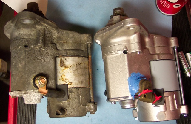

porcupine73 Posted October 13, 2007 Share Posted October 13, 2007 Sometimes it is just the starter contacts that need swapping out. I just bought a Subaru reman starter from subarupartsforyou.com; here's a comparison pic. The reman starter for some reason was missing a rubber boot over one of the contacts, hence the blue rtv holding the one I ripped off the old starter. Quote Link to comment Share on other sites More sharing options...
JGromada Posted October 14, 2007 Author Share Posted October 14, 2007 hey great photo on that last post! I checked it out yesterday and that boot is very loose and the terminals look really dirty. i will pull out the starter and clean it all up and see what happens. Thanks all! Just one other question: That interlock switch that ensures that the transmission is not in gear in order to start; where is that located? Quote Link to comment Share on other sites More sharing options...
