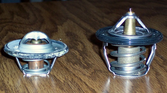

Suzam Posted October 30, 2007 Share Posted October 30, 2007 I'm going with a stuck t-stat. The engine temp mid poing on the gauge is only 10 degrees higher then the opening temp of the t-stat, so it does cycle open closed to keep the temp up. Since yours is stuck open, it never gets a chance to warm up. Also time to change the coolant and radiator cap. mipper +1 on what "Mipper" said. Remeber to get a genuine Subaru OEM t-stat, not aftermarket. Link to comment Share on other sites More sharing options...
porcupine73 Posted October 30, 2007 Share Posted October 30, 2007 Right on, go with OEM thermostat, which is very stout in comparison to aftermarket. Also you need the rubber gasket that goes around the thermostat. Thermostat is in the housing circled in red below: Link to comment Share on other sites More sharing options...

Virrdog Posted November 5, 2007 Share Posted November 5, 2007 Right on, go with OEM thermostat, which is very stout in comparison to aftermarket. Also you need the rubber gasket that goes around the thermostat. I love comparison pics! Which would you rather have in your car?? This shows the rubber gaskets also. Link to comment Share on other sites More sharing options...
