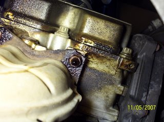

axgutt Posted November 6, 2007 Author Share Posted November 6, 2007 Here's a picture. You can see that another drop of oil is about to fall from the bolt . . . Quote Link to comment Share on other sites More sharing options...
awesomedude Posted November 6, 2007 Share Posted November 6, 2007 Looks like you need valve cover gaskets. Quote Link to comment Share on other sites More sharing options...
fnlyfnd Posted November 6, 2007 Share Posted November 6, 2007 Yea valve cover gaskets....but that still doesn't explain the coolant, so investigate further. Quote Link to comment Share on other sites More sharing options...
