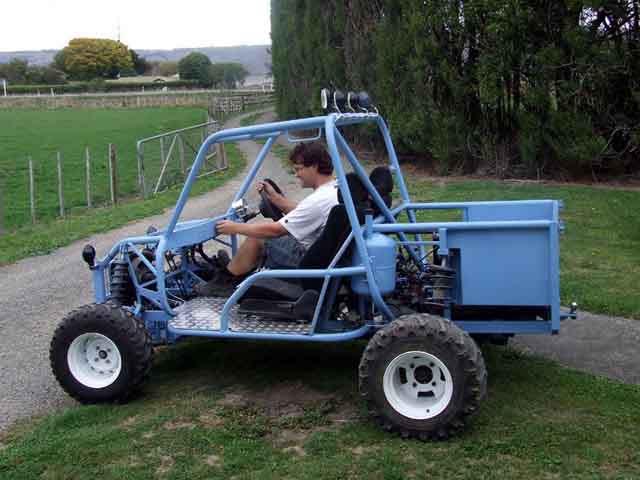

mikie Posted January 7, 2009 Share Posted January 7, 2009 Mid engine is quite doable, A shaft shifter can be done but is a wee bit tricky since it has to get under the engine. Find the right legacy/impreza inner CV joints (22 spline) if you want to mate to the rear axles on the EA rear suspension. The trans is about 1 inch wider than the diff, which is absorbed by the CVs. Attched is pic of buggy a helped a friend build last year using an EA82 engine. Very impressive traction for a 2wd vehicle, but still capable of powersliding. Link to comment Share on other sites More sharing options...
s'ko Posted January 7, 2009 Author Share Posted January 7, 2009 Mid engine is quite doable, A shaft shifter can be done but is a wee bit tricky since it has to get under the engine. Find the right legacy/impreza inner CV joints (22 spline) if you want to mate to the rear axles on the EA rear suspension. The trans is about 1 inch wider than the diff, which is absorbed by the CVs. Attched is pic of buggy a helped a friend build last year using an EA82 engine. Very impressive traction for a 2wd vehicle, but still capable of powersliding. That buggy looks nice. Where is the engine placement? Looks like it's tucked in between the seats. BW Link to comment Share on other sites More sharing options...
mikie Posted January 8, 2009 Share Posted January 8, 2009 EA82 is right behind the seats, it uses a 5spd DR 4wd box for better gearing with the rear output shaft capped off. Even thou its longer than the 2wd box the low range makes it worth while. Link to comment Share on other sites More sharing options...
