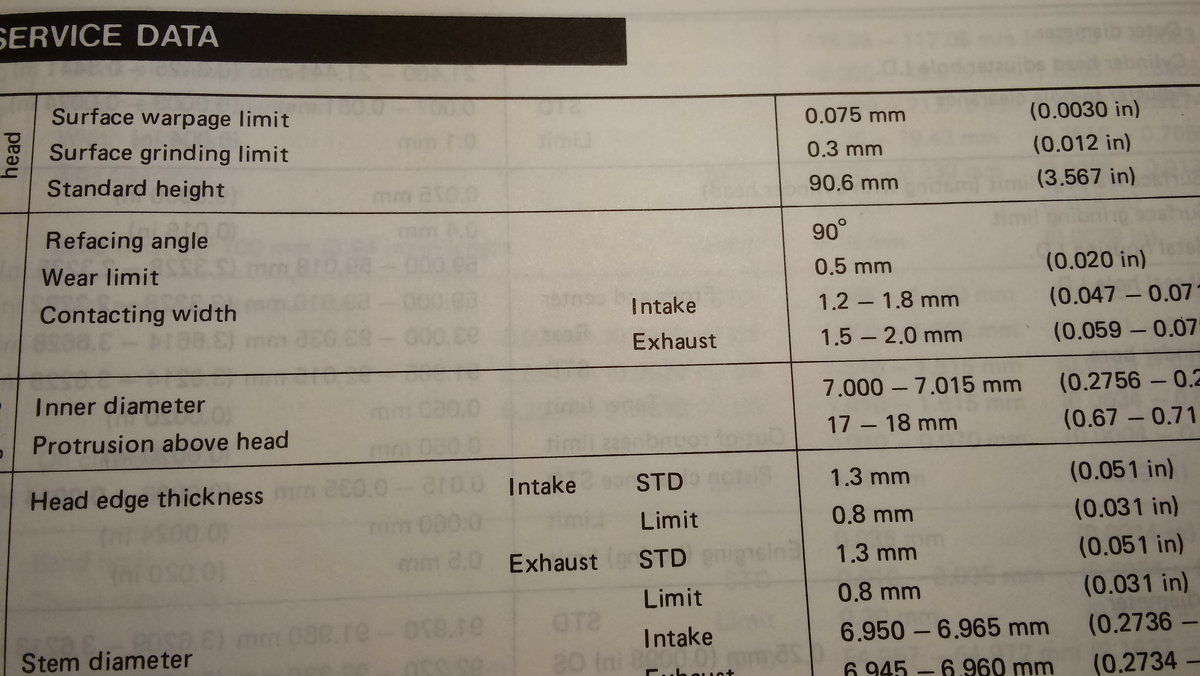

tjet Posted February 27, 2020 Share Posted February 27, 2020 Thanks for the info. On my ER27, it looks like if I mill off 0.014", I will get a 1/2 point bump in CR, so 9.5 to 10:1. My only concern is that the factory shop manual states max resurface limit is 0.012" Link to comment Share on other sites More sharing options...
idosubaru Posted February 28, 2020 Share Posted February 28, 2020 On 2/27/2020 at 11:40 PM, tjet said: Thanks for the info. On my ER27, it looks like if I mill off 0.014", I will get a 1/2 point bump in CR, so 9.5 to 10:1. My only concern is that the factory shop manual states max resurface limit is 0.012" Expand I’ve gone way beyond limits on an EJ engine and it was fine. ferp just described shaving enough to require intake spacers to line up the manifold. That’s almost certainly more than 2 thou past limits. I wouldn’t even sweat 2 thou but I haven’t done it so.....??? Link to comment Share on other sites More sharing options...
