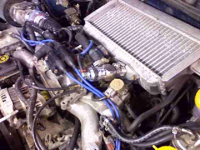

I've got a new set of '97 Outback plug wires I'd trade for a new set for a '96 wires :)
I need to remove the TMIC to get to the ignitor, then relocate it....

new plug wires (though there are *JUST* long enough. really need some longer ones....there is no slack in wire #4 :) )
