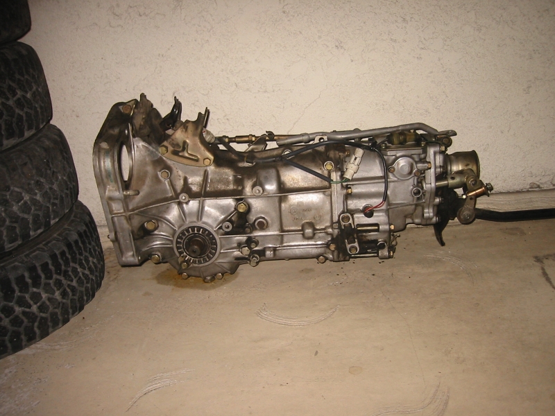

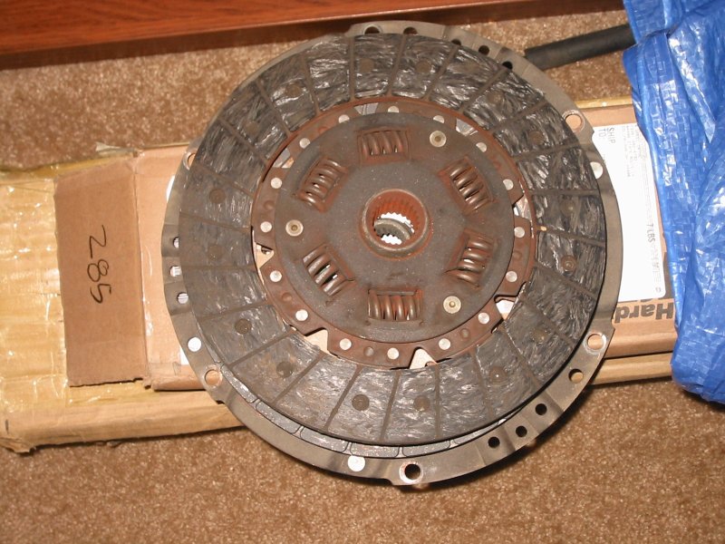

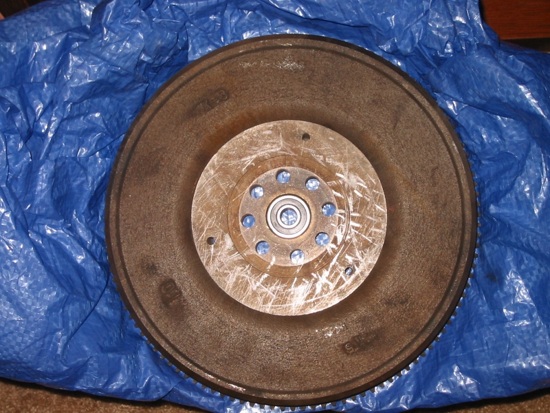

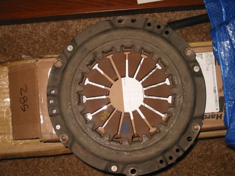

casm Posted January 15, 2008 Author Share Posted January 15, 2008 If it helps to identify them, here're the parts that are going in on Friday. First, the transmission itself (ignore the 4WD shifter linkage on top of it): Next, the flywheel: Flexplate: Clutch (I have another identical one in *much* better shape): I don't know which models these are out of other than the gearbox, so any help with clarifying that is more than welcome. Link to comment Share on other sites More sharing options...
