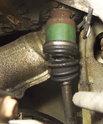

I just had that boot tear on my '96 and replaced it with a Subaru oem reman axle...all the grease all over the cat heat shield is going to smell for a while.[/Quote]
Those pictures look familiar!
Thanks again porcupine for all you do here!
Sounds good! I just noticed the smell in my '96 today but I just replaced the axle this weekend. That's what those pics are from. Those pics are fresh out of the box from this weekend, I've never posted those before. :) I have posted my '00obw pics before though, I used an MWE axle on that one which worked fine; thought I would try an OEM this time seems to be working well too but is like twice the price.
