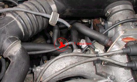

Skip Posted February 4, 2008 Share Posted February 4, 2008 First, a thaks to Jules for posting this. Second, a thanks to Gary for mentioning the filter. Third, I confess to being a big dummie - Red Fox size. My 97 OB with a 2.2 swap also has this error code. That is why I knew where to look to take the picture. Now the big dummie part. I went out to get a picture for Jules of the filter and lo and behold. Mine is hanging on the end of a hose going nowhere!!! Can anyone tell me where it is suppose to connect. I saw no open nipples on the intake. Ya big dummie!! Link to comment Share on other sites More sharing options...

idosubaru Posted February 4, 2008 Share Posted February 4, 2008 quit calling my friend skip a dummie! awesome skip, that's sweet! it runs fine like that? from memory i believe there's a T fitting from that hose you can see in the same picture. looks like yours might not have it. the hose i'm speaking of is the one facing the passengers seat parallel to the ground so to speak, at least coming out of the intake it's || to the ground. this hose should have a T fitting that your filter hose connects to. Link to comment Share on other sites More sharing options...
OB99W Posted February 4, 2008 Share Posted February 4, 2008 [...]Mine is hanging on the end of a hose going nowhere!!! Can anyone tell me where it is suppose to connect.[...] From the pic, it looks like you have a vacuum hose running from the nipple on intake manifold #3 runner going directly to (I assume) the fuel pressure regulator. There's supposed to be a short piece of hose from that nipple to a T, then the hose from the T continuing to the regulator. The loose hose with the filter should be routed under the intake, and connected to the center nipple of the T. While you have the hood up, see if there's an emission control diagram pasted to it. It won't show the physical routing, but should give the hose schematic. Link to comment Share on other sites More sharing options...

Skip Posted February 5, 2008 Share Posted February 5, 2008 Okay guys, Please let me rectify the situation. First, thanks for the help, I'll email ya Dave. Second, I'm the big dummie (so called by I) Here I am, offering all this help and then standing "nekid" in front of the crowd. (hangs his head in the shame of it all) thanks Steve if you're watchin' Third, My man OB99W nailed it with his picture. (pictures do help, I hope we all learn a lesson from this) My swapped engine did not have this "T" fitting he shows. As my penitence.. I will and do so promise to correct this error tomorrow and post a follow up. I will just possibly - add a "must check" on EJ25 to EJ22 swaps for all those interested. We/I owe a thanks once again to Jules for asking and to Gary for bringing up the filter. Thanks to all, I'll go grab a towel now to cover my privates. Link to comment Share on other sites More sharing options...
OB99W Posted February 5, 2008 Share Posted February 5, 2008 [...]Third, My man OB99W nailed it with his picture.(pictures do help, I hope we all learn a lesson from this) My swapped engine did not have this "T" fitting he shows.[...] I take no credit for the original picture -- it's your pic Skip, which I: 1) downloaded 2) converted to bitmap 3) "Painted" 4) cropped to reduce bandwidth 5) converted back to JPEG 6) uploaded I'm sure all the manipulation contributed to the blur, but if it got the job done... Link to comment Share on other sites More sharing options...
