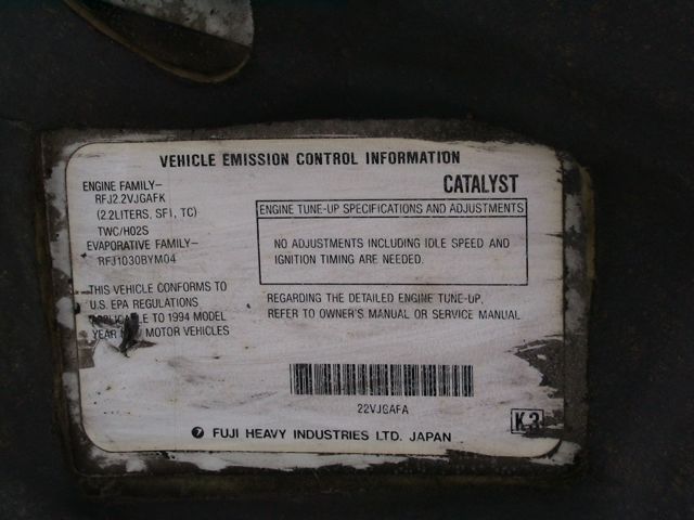

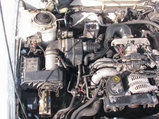

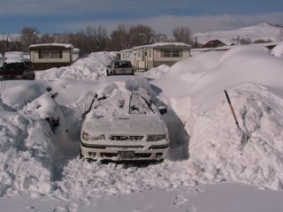

subsince77 Posted February 5, 2008 Share Posted February 5, 2008 This will probably get a little long, so sorry in advance. As I am waiting to get my OBW repaired, I have been watching the local paper for Subarus. There have only been a few, but this week an ad showed up for a 94 wagon for $300. The ad simply says, "doesn't run, but might be a simple fix for someone that knows what to do." So Today I got in touch with the owner. He is a college student, lots of those here, and he doesn't know much about the car. He said he bought it from a girl he knew in Denver. She had started having problems with the car dying at stop lights. He drove it for a while, presumably brought it here to school, but the problem started getting worse. He said that finally it would die every time he stopped, then the last time, he could not restart the car. He said that this girl was told by a shop in Denver that it needed "a wire harness" replaced that would cost $400. That is why she sold it to him. So, he told me where the car was parked, and I went to look at it. It, like many other cars in Gunnison this year, is under about two feet of snow. I brushed off the front just to be sure that the small part of a front fender I could see was actually a Subaru. The hood had about a foot of snow, the rest of the car is really buried, so I don't know too much about it. I got inside after digging out the riders side door. It is a 94 legacy wagon with a 4 speed automatic transmission. The shifter has a button on the side (two actually) that says "manual" by it. Is that a 4wd button, or something else? The interior looks good, some college kid trash on the floor, but pretty clean and not torn up. It has at least some rust, and the riders outside mirror is gone. It also needs a windshield. Looks like a recent break, actually it looks like someone stepped on it. It has an electric sunroof, and, wait for it, the odometer says 120,000 and change. Practically brand new for a 2.2L There were some papers on the seat saying it had passed emissions in Denver last spring, and an oil change sticker on the windshield that was 3000 miles old. 10/30 though, too thick for a Gunny winter. He had told me the key was there but the battery dead, and that was right, no power at all. I popped the hood and climbed back out. As I pushed the rest of the snow off, I found an intake, must be a turbo says I, and sure enough it is. Opened the hood, it is as expected, a 2.2L turbo. The plug wires look like they might be original, so it might need new ones. Fuel filter looked old. Oil was full. One thing I saw was that the right (riders) side of the timing belt cover was broken off - not good, but the belt was there, so it has one. It did not appear to be leaking oil at the bottom of the timing cover, or onto the exhaust right below that. Left valve cover was dry, right valve cover had oil on top, maybe from the timing belt area? I didn't get underneath because of the snow. One other thing. On the left (drivers) side of the engine compartment there are three bundles of wires that come in right near the battery (an interstate by the way). The top bundle looked like it had been cut apart with a knife, then each wire put back together with electrical tape. Scary. Could this be what the shop was saying needed to be replaced? i don't even know what it is. So, those of you that have read my posts know I'm a really basic mechanic at best. I don't know why I'm drawn to this car, I guess it's just the possibility that it might be a jewel for $300 and some work. I haven't given you much to work with here i know, but what do you think? I guess my next step is to put some power to it and see if it has spark. Maybe give it a fuel filter and some plugs and wires. If I bought it, any serious work would have to wait until spring. Are these turbos a problem? Any thoughts would be helpful. Thanks Quote Link to comment Share on other sites More sharing options...
pearlm30 Posted February 5, 2008 Share Posted February 5, 2008 wow, what a great deal. You cant go wrong with $300 on a 94 turbo wagon with low miles. The no start problem could be one of the cam sensors, and stalling problem could be MAF. Good luck:banana: Quote Link to comment Share on other sites More sharing options...
GeneralDisorder Posted February 5, 2008 Share Posted February 5, 2008 That's a good, low mileage for a 22T. Excelent deal if the body isn't too rusty. Even then you could rip the engine out and sell it for a grand. They are very sought after being Subaru's only 2.2 fully closed deck block. Legendary so to speak. With some WRX 2.0 or Gen 1/2 2.5 heads, an intercooler and a larger turbo there's quite a number of folks into the 300 HP and low 12 second range. The auto tranny can be swapped and frankly isn't a big deal since the manual's they came with are weak at higher performance levels. They are about as reliable as the N/A 22. Only real problems with them generally stem from poor maintenance. Right before Subaru originally introduced the Legacy in 90 (so late 89) they brought a handful of these turbo's to the US and ran them 24/7 for several weeks stopping only for routine maintenance. The cars racked up something like 65,000 miles without a single failure. The cooling systems need to be maintained. If they go things get ugly in a big way. I just aquired a 91 SS (Sport Sedan) that hasn't seen the road in three years due to a cooling system mishap that took out the engine (melted the block), radiator, and heater core all at once. These engines are rare, parts tend to be expensive, and it was around $5,000 to put it back on the road.... and I've not even started modding it yet. The only thing that's somewhat distressing about the engine itself is they have piston oil squirters in the crank that have a tendancy to fall out - this can lead to a lack of lubrication to other critical engine parts as there will be a pressure loss when the spray nozzle is gone. There's four of them and folks have reported as many as three of them falling into the oil pan. It's also pretty much agreed that they are uneccesary. Much higher performing turbo's including the 22B Impreza (280 HP on the same block) never came with them. The thought is that Subaru was overly cautious about their reputation in the US market at the time and added them due to fears of piston overheating because of the lack of an intercooler on these models. It's a complete engine teardown to plug them though so unless you find them in the pan it's not a huge worry. The turbo's only came as either the Sport Sedan (manual and auto versions), and the Touring Wagon (auto only). 160 HP, 181 Ft/lbs stock. Sounds like a pretty easy fix. It's most likely a sensor or something on the fritz making it not idle. A hookup to the B10 scan tool will tell you much: http://www.graphics.cornell.edu/~v/b10scan/ GD Quote Link to comment Share on other sites More sharing options...

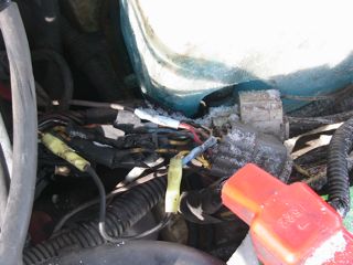

Rooster2 Posted February 5, 2008 Share Posted February 5, 2008 From your description, it sounds like this car is repairable. If you offered the kid $150, he would prolly take it. It doesn't sound like it would take a lot to get this car running. I don't understand about all the wiring being cut, then reassembled with tape. I wonder whose bright idea was that? With some patience that is fixable. No need to buy a new wiring harnass. I wouldn't be surprised that with a new set of plugs and plug wires, that the car would run well again. You may have found a nice jewell! Quote Link to comment Share on other sites More sharing options...

njdrsubaru Posted February 5, 2008 Share Posted February 5, 2008 yeah offer him $150! :lol: well go down to 200 and meet in the middle 250 maf sensor, O2 sensor, plugs, wires, filters will need to be changed... clean AIC valve and throatle body, all this can be done in less than a day. oh one more little annoying thing... knock sensor! also check the fuel pump.. i just got a used one from the JY for 5 bucks.. so they are cheap remember this: the 2.2Ts are NOT gas savers, at the best you'll get 20 mpg at worse you'll get 12-14mpg Quote Link to comment Share on other sites More sharing options...
msmithmmx Posted February 5, 2008 Share Posted February 5, 2008 Yep, do it. Quote Link to comment Share on other sites More sharing options...
GeneralDisorder Posted February 5, 2008 Share Posted February 5, 2008 maf sensor, O2 sensor, plugs, wires, filters will need to be changed... clean AIC valve and throatle body, all this can be done in less than a day. oh one more little annoying thing... knock sensor! Knock sensors went through a revision, but only change it if you are getting the code for it. Buy a new one they are only about $55. also check the fuel pump.. i just got a used one from the JY for 5 bucks.. so they are cheap Fuel pumps are not the same for the N/A vs. Turbo. If it needs a pump it's best to just buy a Walbro for it. emember this: the 2.2Ts are NOT gas savers, at the best you'll get 20 mpg at worse you'll get 12-14mpg Agreed - they can get up to 25 or so highway though. In town is usually around 18 or less. All turbo's run crazy rich - more air means more fuel = more power. Especially under boost. GD Quote Link to comment Share on other sites More sharing options...

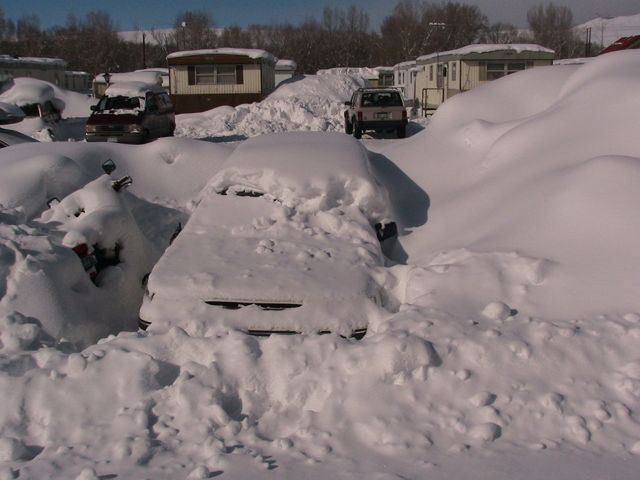

subsince77 Posted February 6, 2008 Author Share Posted February 6, 2008 Sorry everyone, it turns out it was over before it began. This guy had this car, and a Geo Metro that had been crushed by snow and ice falling off a building for sale, and someone bought them both last night while, or maybe before I was making my first post. Had I known what a unique car it was I wouldn't have even hesitated that long. There was probably only about a 30 minute window that was open to me. I couldn't reach the guy all day, so I was working on the assumption that as soon as I could get him the car was mine. I had left several messages and I had the cash in hand. I tried, I really tried! I was never even able to meet the owner because he was busy last evening - bummer! i didn't find any of this out until about 5 pm today. I am very disappointed, but what are you gonna do? I sure wish i hadn't spent all that time moving snow for someone else though. i have been getting enough of that as it is. Thanks for all the help and encouragement. Quote Link to comment Share on other sites More sharing options...
