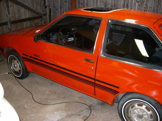

SUBARU3 Posted December 21, 2008 Author Share Posted December 21, 2008 Dodge Colt! and guess what else I have??? I'm glad we have an option for this! Todd http://www.ultimatesubaru.org/forum/showthread.php?t=93046 Link to comment Share on other sites More sharing options...
