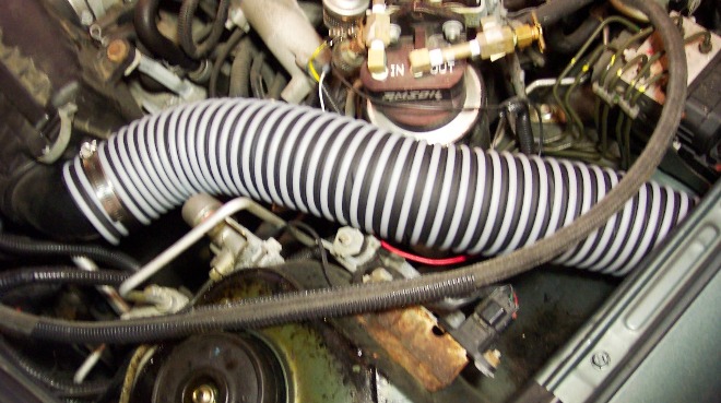

porcupine73 Posted February 29, 2008 Share Posted February 29, 2008 Ah I don't know. I've heard about drilling holes in the airbox too. But then it's going to be sucking in warm/hot air from the engine compartment rather than cooler air from the front. If you want to really hear your boxer, run some flex tube into the passenger wheel well. The hole is already there. I did it as a test, and man you could really hear the engine pretty loud. Unfortunately intake noise isn't the prettiest sound, it sounded more like a ricer with the farty muffler. When it shifted made a neat sound though. LIke this: Link to comment Share on other sites More sharing options...
nipper Posted March 1, 2008 Share Posted March 1, 2008 Ah I don't know. I've heard about drilling holes in the airbox too. But then it's going to be sucking in warm/hot air from the engine compartment rather than cooler air from the front. If you want to really hear your boxer, run some flex tube into the passenger wheel well. The hole is already there. I did it as a test, and man you could really hear the engine pretty loud. Unfortunately intake noise isn't the prettiest sound, it sounded more like a ricer with the farty muffler. When it shifted made a neat sound though. LIke this: I really think that cooler fresh air is somewhat bunk on subarus. The engine compartment isnt so cramped that there is no airflow, unlike other cars. I know from having my mirror temop sensor in the wrong place, that fresh air aint all that cold (especially in summer.... blacktop gets hot). Personally i think its one of those things that work great for the lab, emission testings and on the test track, but on a day with the sun beating down on the blacktop, doesnt have that much of an effect. I think its more for noise control at this point. I still have a nice new CAI for Blu, just waiting for the weather to warm up to put it in. As for suspension, your struts are very tired, that will help handling tremendously, and a thicker sway bar. nipper Link to comment Share on other sites More sharing options...
porcupine73 Posted March 1, 2008 Share Posted March 1, 2008 Hm yes not sure, I know from monitoring the scangauge, in the summer in '00obw without the intake snorkus attached, she's pulling 130-150F intake air temp. With the snorkus on it goes down to maybe 90-100F or so. Typically on my soobs I run without the snorkus in the winter, and with in the summer. Link to comment Share on other sites More sharing options...
