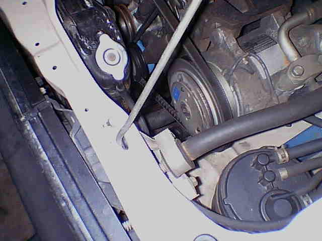

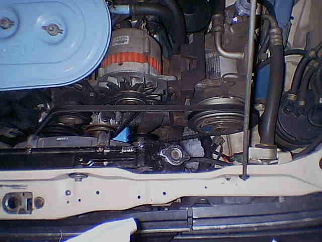

bheinen74 Posted March 4, 2008 Author Share Posted March 4, 2008 these 2 pics show the clearances stock form. the lower radiator outlet might interfere once the engine drops the 4" with the guide pulley, and mostly the belt. i think a 2" lift might be more do-able Link to comment Share on other sites More sharing options...
The Beast I Drive Posted March 4, 2008 Share Posted March 4, 2008 Make the Bracket so the compressor stays in the exact same place it is or a little higher and more over the alternator, but I know for a fact it can be done, it isnt that difficult, and I have seen the end result in action. Also the guide pully can be moved if the need be, or you could get a water pump pulley with the 2 grooves, I dont recal which cars had them, but some EA81s did and then no need for the guide pulley Link to comment Share on other sites More sharing options...
bheinen74 Posted March 4, 2008 Author Share Posted March 4, 2008 yes the AC compressor needs to stay within 1/2" of stock, but, when the crossmember, and engine drop the 4". it lowers the guide pulley (on engine) and it will make the AC belt, attached to the crank pulley, drop so the Belt inteferes with the lower radiator output for the hose. Make the Bracket so the compressor stays in the exact same place it is or a little higher and more over the alternator, but I know for a fact it can be done, it isnt that difficult, and I have seen the end result in action. Link to comment Share on other sites More sharing options...
