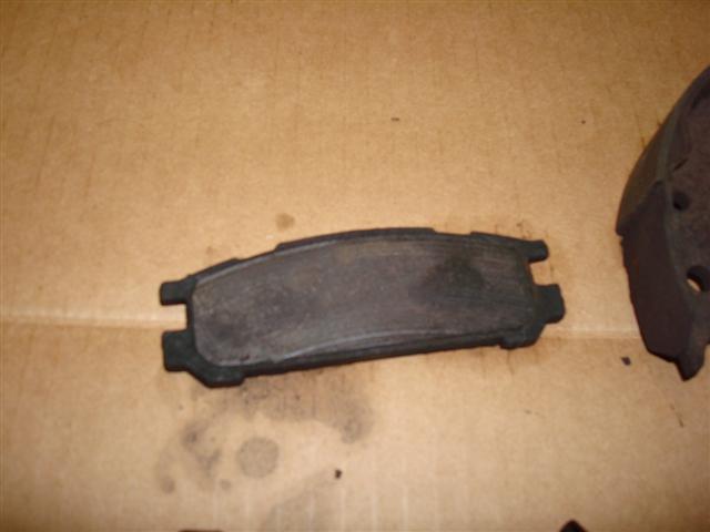

1) Need new back brakes (70 bucks with rotors)

By the way, I have a set of rear rotors if you want them. If they are actually going to replace the rear shoes and rotors and pads for 140.00 you are very lucky. Last time I looked up the e-brake shoes the kit was 300.00. That didn't include the rotor. I also have a set of rear pads in good shape.

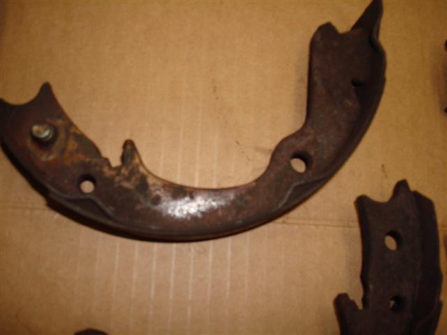

The parking brake is what gets me. Are they serious?? I've never seen a set of e-brake shoes worn to the point of needing replacement. Just an adjustment should be fine.
Not a Subaru example, but when I did the brakes on my mother-in-law's Grand Cherokee, the e-brake shoes were shot - lining was completely absent. I was very surprised, but if you leave the parking brake engaged for long stretches of time, they could seize & wear down.
The more amazing thing is that they took off the rear rotors to check. If they didn't do this, just try adjusting the shoes and then the e-brake cables under the console as already suggested.

I doubt they actually did take off the rotor. Just pulled and got nothing so they said "all new everything" for that system, the typical repair shop/liability/cover your rump roast line of thinking.
I am doing the work myself. There is no way they pulled the rotors off to check the shoes. They pulled the lever and got nothing.... Work starts tommorow on this car. My guess is 2 nights after work should do it. on my list of things to do all they wanted to do is replace the front tire. I am addressing the wheel bearing because it has been making anwefull noise for 20K miles and I sure is the cause of the inside of the wheel being bald
Adjust the brake before you get in there and replace. My wife's car had no e-brake, 10 minutes of adjusting and she's fine now. Easier and cheaper. If the rotor is bad, then you will have to pull it and then you can get an idea of the wear on the shoes.
