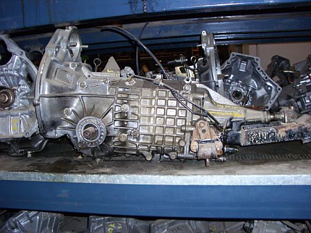

Crabman Posted April 8, 2008 Share Posted April 8, 2008 Hey fellas, I have toyed with the idea of putting a 2WD 5-spd transmission in my brat. And now it seems like I have located a transmission, I'm trying to figure out if I should go for it or not. I have read some varying opinions of the difficulty of the swap. I have heard that its a "bolt-on" job, I have also heard that some fabrication is required. Can anybody give me the skinny on exactly what this will take? And can you also take a look at the picture and let me know if I am looking at the right transmission, if it will mate to my EA71? The seller only describes it as a "77-84 1600/1800/Brat trans" Thanks, Crabman Quote Link to comment Share on other sites More sharing options...

SUBARU3 Posted April 9, 2008 Share Posted April 9, 2008 I believe you will encounter issues with the rear crossmember/trans mounts, as they differ, the exhaust hangers and the position of the opening in the floor. If you have access to a 2 wd pats car, you will have it made. Todd Quote Link to comment Share on other sites More sharing options...
Crabman Posted April 10, 2008 Author Share Posted April 10, 2008 OK finally attached a better picture. Does that look like a Gen 1 tranny to you fellas? Well changing exhaust hangers wouldn't br a big deal, but if I needed crossmember/trans mounts of a gen 1 2wd, I think I would be out of luck. Gen 1s are almost non existent out here. And its outside my ability to fabricate that sort of thing. Guess I will let this one go, and focus on other improvements. Quote Link to comment Share on other sites More sharing options...
SUBARU3 Posted April 11, 2008 Share Posted April 11, 2008 It looks like a late EA71 trans. Like a gen 2. The rubber mount is different on Gen 1/2WDs, but I think you could make it work. The 2WD rubber mounts on Gen 2/ 2wd's are the same as the Gen 1 4wds. But the Gen 1 2wds had a rubber mount that was on the bottom, not the sides of the trans. Todd Quote Link to comment Share on other sites More sharing options...
Crabman Posted April 14, 2008 Author Share Posted April 14, 2008 Hey Todd, Thanks for the response. I'm trying to get the gist of what you are saying. So, would I have better luck putting a 2WD tranny from a Gen 2 in my Gen 1 Brat? If so, would it be a 'bolt-on" operation, or would there be other special considerations, fabrication and what not involved? Thanks, Crabman Quote Link to comment Share on other sites More sharing options...

spigma01 Posted April 20, 2008 Share Posted April 20, 2008 If you can try and look at the two trannys on the ground next to each other. The only difference should be that you might have to move the mounts, though the holes should already be there and have threads. Quote Link to comment Share on other sites More sharing options...
