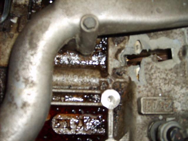

90legacywagon Posted May 30, 2008 Share Posted May 30, 2008 Today I replaced the #2 fuel injector on my 90 legacy wagon, 2.2L, 2wd, auto. I've done this 3-4 times on the same car. This time however, was different. After installing the new injector, I went to start the car, and I heard a loud "clunk" from the engine, and then all went still. I tried to start the car a couple of more times, and it finally started, only now it runs with a very loud knocking sound coming from the engine, and it also runs like crap. I suppose I should mention that I did not (and never do) relieve the pressure from the fuel pump, and some fuel went into the hole (cylinder) that the fuel injector sits in. But that's happened before and I didn't have any problem. Did I do some major damage here? I'm guessing the fuel went into the cylinder, and the piston couldn't compress it and I bent something? Link to comment Share on other sites More sharing options...

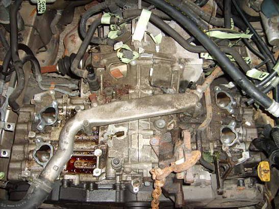

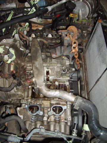

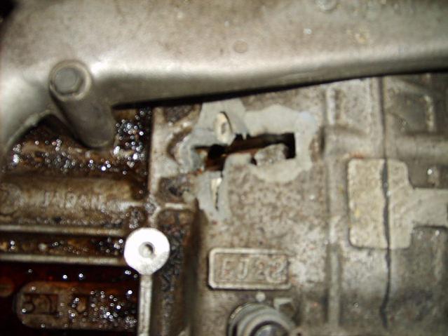

90legacywagon Posted May 30, 2008 Author Share Posted May 30, 2008 *UPDATE* On further inspection, and judging from the oil spray and metal shards in and around my engine compartment, I have done some major damage. Oh, there's also the matter of the very large crack/hole in my intake manifold...about 4" behind the EJ22 stamp, behind the alternator, which is brand new by the way. Great. Today I replaced the #2 fuel injector on my 90 legacy wagon, 2.2L, 2wd, auto. I've done this 3-4 times on the same car. This time however, was different. After installing the new injector, I went to start the car, and I heard a loud "clunk" from the engine, and then all went still. I tried to start the car a couple of more times, and it finally started, only now it runs with a very loud knocking sound coming from the engine, and it also runs like crap. I suppose I should mention that I did not (and never do) relieve the pressure from the fuel pump, and some fuel went into the hole (cylinder) that the fuel injector sits in. But that's happened before and I didn't have any problem. Did I do some major damage here? I'm guessing the fuel went into the cylinder, and the piston couldn't compress it and I bent something? Link to comment Share on other sites More sharing options...

90legacywagon Posted April 26, 2009 Author Share Posted April 26, 2009 to take out the spark plugs and suck out the fuel when you let fuel go into your cylinder while changing fuel injectors...see the hole in the block? This is an update to a thread I posted last year, although last year I thought it was the intake manifold and was less concerned. I have a question related to this problem...I cannot get the engine out. It is seized up, and I cannot turn the crankshaft to get to the bolts in the torque converter service hole. I have taken the spark plugs out, filled the cylinders will PB blaster. It will not turn. I thought it was starting to turn the other day, so I gave it a pull and broke the bolt head off of the crankshaft. I then tried using a giant pipe wrench to turn the crankshaft sprocket gear and it broke off. I can still get a grip on the slick bare crankshaft but do y'all think it is possible that whatever happened to cause the block to explode like that jammed something up inside so much that I will never be able to turn the crankshaft? Any suggestions? Link to comment Share on other sites More sharing options...
