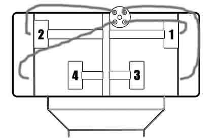

just got my engine in everything hooked up. BUT no run it's a EA82 turbo. I've got fuel and spark, but the disty might be off. I know the firing order is 1342, but what is the orientation on the motor. any tips would be appriciated. thanks jay

The firing order is 1324 not 1342. That might be where you should start looking :) If you have removed the dist. and reinstalled it then I would also look there more closely. Make sure it is not a tooth or 2 off. Make sure it isnt 180 off.
Did you touch the timing belts? If so make sure they havent slipped a tooth and that they are properly installed.
