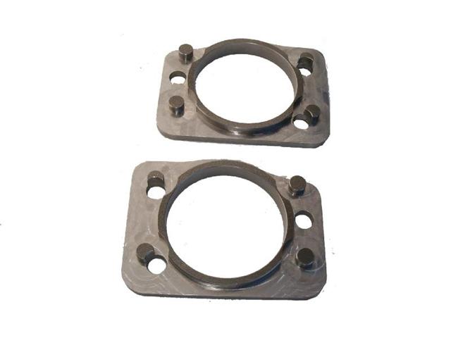

rguyver Posted August 13, 2008 Share Posted August 13, 2008 Along with the motor/ tranny adapters im also going to bring the weld in ring spacers for the rear brake EA EJ swap . 10$ for one set call dibs i have 5 sets see inner ring welded in then drilled to fit the older bolt pattern . Link to comment Share on other sites More sharing options...

rguyver Posted August 14, 2008 Author Share Posted August 14, 2008 Can you do a set for a set of STi Brembos? I'm willing to pay extra for a set if you can. ya they must have different hub sizes for the sti and that is what i sent you ill have to measure some leg. rear hubs i thought they were all the same . how much were they out ? Link to comment Share on other sites More sharing options...
rguyver Posted August 14, 2008 Author Share Posted August 14, 2008 Can you do a set for a set of STi Brembos? I'm willing to pay extra for a set if you can.thats what i am have i thought they were all the same ill have to do a re check . Link to comment Share on other sites More sharing options...
JWX Posted August 14, 2008 Share Posted August 14, 2008 I will buy a set and pay for shipping. Will you be building these after the show or is it a one time affair? Link to comment Share on other sites More sharing options...
suberdave Posted August 14, 2008 Share Posted August 14, 2008 ya they must have different hub sizes for the sti and that is what i sent you ill have to measure some leg. rear hubs i thought they were all the same . how much were they out ? like i said the ID was fine, the OD was close to 3/16" to large. -=Suberdave=- http://www.suberdave.com Link to comment Share on other sites More sharing options...

rguyver Posted August 14, 2008 Author Share Posted August 14, 2008 I will buy a set and pay for shipping. Will you be building these after the show or is it a one time affair? looks like the ones i have are all for the brembos so i will make new ones in the smaller size and i will ship them . ill repost when i have the new ones made , thanks Link to comment Share on other sites More sharing options...
rguyver Posted August 14, 2008 Author Share Posted August 14, 2008 like i said the ID was fine, the OD was close to 3/16" to large. -=Suberdave=- www.suberdave.com sorry about that ill get you a new set in the smaller size no charge but it will have to be after the WCSS . Link to comment Share on other sites More sharing options...
