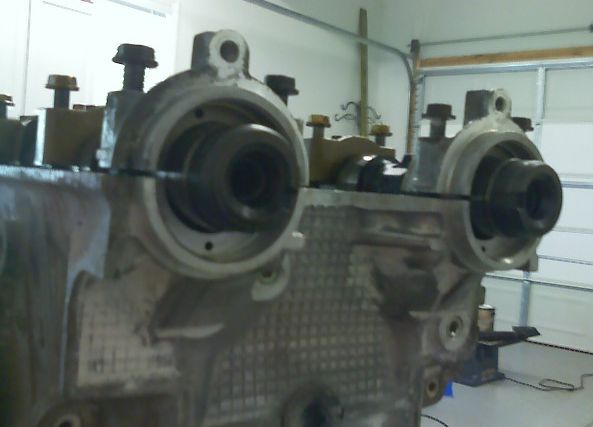

msmithmmx Posted August 17, 2008 Share Posted August 17, 2008 I am putting back together my 2.5 (blown HG). The problem I am having is the front cam caps are not sitting on the head flush, there is a gap. I have not tried to wrench them down yet in fear of stripping the head. What is the trick for getting those cam's to sit deeper? Pic inclosed. Thank You for any help Link to comment Share on other sites More sharing options...
davebugs Posted August 17, 2008 Share Posted August 17, 2008 Is it only the front ones that won't 'seat' or is is all of them for each cam including the ones under the valve cover? I don't recall having any issues. Unless on those front ones somehow you forgot to remove the old RTV in the corners. Dave Link to comment Share on other sites More sharing options...
msmithmmx Posted August 17, 2008 Author Share Posted August 17, 2008 All of them have gaps, both cams. Does wrenching them down in order press the valves down thus closing the gap? Link to comment Share on other sites More sharing options...

msmithmmx Posted August 17, 2008 Author Share Posted August 17, 2008 I have only tried the passenger side at this time. It is every cam cap, 6 in total that are not 100% flush with the head. I am assuming that I need to crank them down and that will depress the lifter and make it all fit. Link to comment Share on other sites More sharing options...
subaru360 Posted August 17, 2008 Share Posted August 17, 2008 You need to have the cams in so that the heel of the cam is towards the lifter. In other words the lifter isn't being lifted. Link to comment Share on other sites More sharing options...
msmithmmx Posted August 17, 2008 Author Share Posted August 17, 2008 I am going to rotate the crank shaft in the correct position and then I should be able to push the cam's down thus depressing the lifters. Link to comment Share on other sites More sharing options...
hooziewhatsit Posted August 18, 2008 Share Posted August 18, 2008 Just read through it again, and it sounds like you just need to tighten the bolts to depress the springs. If the cam is turned so a lobe is pushing on the rocker, it won't sit down all the way (obviously), so you can either turn the cam, or just crank it down. -Dave Link to comment Share on other sites More sharing options...
McDave Posted August 18, 2008 Share Posted August 18, 2008 It seems like to me both the cams and crank would need to be timed correctly before tightening the cams down if this is an interference motor. And no matter how you have the cams timed, there will always be some valves that will be holding the cams up. Those cam towers need to be tightened first so the cams will go down level. I sure would consult the fsm before assembling this motor. Link to comment Share on other sites More sharing options...
subaru360 Posted August 18, 2008 Share Posted August 18, 2008 ^^^No Put the crankshaft on the timing mark. Set the cams in so no lobes are pushing on lifters. Then the cams will sit all the way down. Then tighten the cam caps. Then turn the cams to the timing marks and put the belt on. You won't bend valves just turning the cams with the engine off. I have built 30+ EJ dohc engines, trust me you can spin them 360 degrees. Link to comment Share on other sites More sharing options...
McDave Posted August 18, 2008 Share Posted August 18, 2008 ^^^No Put the crankshaft on the timing mark. Set the cams in so no lobes are pushing on lifters. Then the cams will sit all the way down. Then tighten the cam caps. Then turn the cams to the timing marks and put the belt on. You won't bend valves just turning the cams with the engine off. I have built 30+ EJ dohc engines, trust me you can spin them 360 degrees. Thanks that's good to know. Does that apply to the 2.5 sohc engines too? Link to comment Share on other sites More sharing options...

msmithmmx Posted August 19, 2008 Author Share Posted August 19, 2008 I had the heads machined along with a valve job. My issues is the lifters slash buckets are in the way of the cam sitting all the way down so the cam caps are flush to the head. If I put pressure on the cam I can push the lifters down. I will have to push the cam down whiling tighting the caps. Link to comment Share on other sites More sharing options...
msmithmmx Posted August 19, 2008 Author Share Posted August 19, 2008 I installed the first cam. The cap went flush and I have a good fit. ONE MORE QUESTION. I think i have the hydraulic bucket lifters. Where does the cam need to be in order for me to check for clearances? Do I need to prime the buckets before I install them back in? Link to comment Share on other sites More sharing options...
