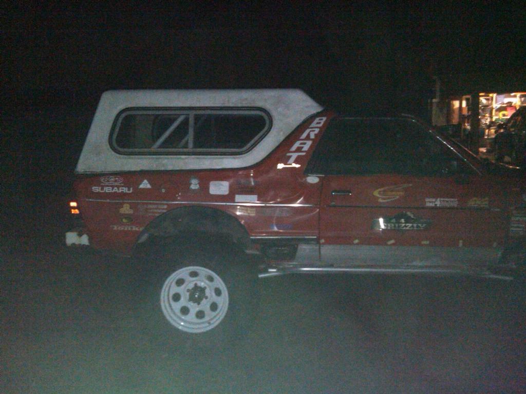

mcbrat Posted November 10, 2011 Author Share Posted November 10, 2011 a better pic... finally found some daylight... Link to comment Share on other sites More sharing options...
