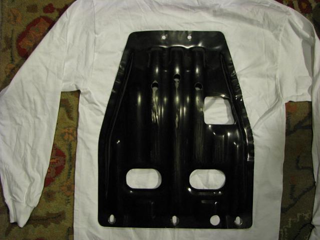

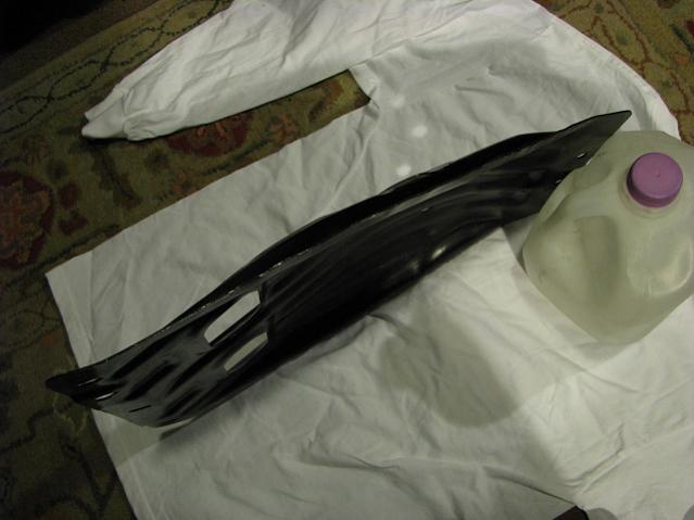

98obster Posted December 18, 2008 Share Posted December 18, 2008 hey, I'm wondering if this is the plate you are looking for. I think it's off an 84 or 85. if you fab on then you are probably looking for more coverage than this 18" long, front bolts 11.75", rear bolts 2.5": Link to comment Share on other sites More sharing options...
