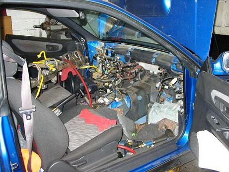

2.5GL Posted January 23, 2009 Author Share Posted January 23, 2009 Dash out, after 25 min of effing with the stupid alarm wiring (freakin' car toys put wires going everywhere, some going nowhere, others right back to where the came from, or close to it...) Now for the dash support/side impact bar, evap, and heater boxes!!! .......... Link to comment Share on other sites More sharing options...

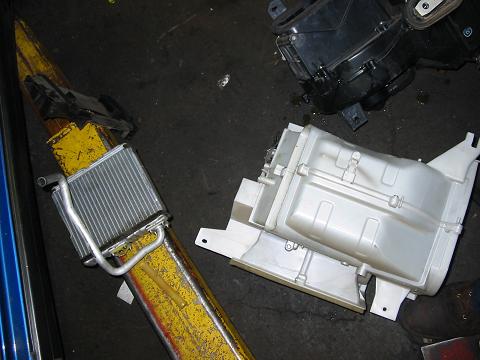

2.5GL Posted January 23, 2009 Author Share Posted January 23, 2009 Its out, and wet, just can find the origin of the leak... stay tuned... Link to comment Share on other sites More sharing options...
2.5GL Posted January 23, 2009 Author Share Posted January 23, 2009 Well, here it is... going to install the one from a 19,000 mile forester donor. yeah, the plastic pipe is busted, I did that on the removal good thing I'm not re-using it. (make sure your pipes are well lubed prior to removing box from car, try to get a long pick device through from the engine side with WD-40 or similar.) Link to comment Share on other sites More sharing options...
2.5GL Posted January 23, 2009 Author Share Posted January 23, 2009 Ahhhh, 12:30 and I'm finished... Cooling system burped, A/C evacuated and recharged, alarm re-installed, and everything works! yay! Now, just have to be back to work in less than 8 hours. :-\ Link to comment Share on other sites More sharing options...
