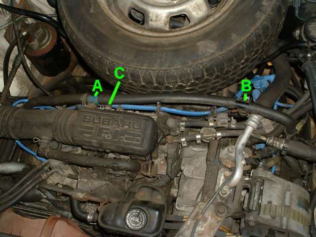

DaveT Posted February 2, 2009 Share Posted February 2, 2009 (edited) There is an official Subaru modification kit to fix this problem. I do not know if it is still available. Refering to this picture: http://www.ultimatesubaru.org/forum/attachment.php?attachmentid=6112&d=1233549601 The kit includes the "T" at A, and the "T" at B, the plug at C, and the hose between them. This picture is after the kit is installed. The original system had a small ellbow at C, a smaller hose from C to the "T" at B, and the original "T" had a smaller port. Also, an ellbow at A. After installing this kit, I have never had the problem again. Edited February 2, 2009 by DaveT Link to comment Share on other sites More sharing options...
Loyale 2.7 Turbo Posted February 2, 2009 Share Posted February 2, 2009 Excuse me, please if I Ask a Dumb Question, but I Can not see Clearly it in the Picture, so I`ll Ask: Now with that new Route, Both Heads Connect Together But with Two "T" Connections, at point A and B of your Picture. So, Where Does the PCV Connects? ... At Point B? ... Then the Opening from Point A is Connected to Point C, isn`t it? Link to comment Share on other sites More sharing options...
DaveT Posted February 2, 2009 Author Share Posted February 2, 2009 Now with that new Route, Both Heads Connect Together But with Two "T" Connections, at point A and B of your Picture. Yes. So, Where Does the PCV Connects? The PCV connects where it originally did, the tap of "T" B that is facing down. The port C is pluged as part of the modification. I added a link to a bigger picture to the original post. (I hope) Link to comment Share on other sites More sharing options...
