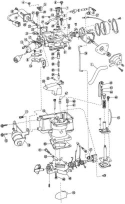

Good news! im making progress! still not fixed but getting close. I disconnected the throttle cable and sure enough the car started idling between 2000-2500.( better than 3200!) but i just can't seem to figure out why it's still idling that high. I feel like an idiot admitting this but i cannot for the life of me find an idle adjustment screw on the carb. thank you for those schematics but they are to small to read. it would be great if anybody had a bigger diagram
