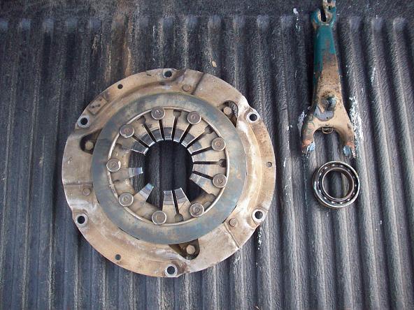

GREENSUBIE Posted February 20, 2009 Share Posted February 20, 2009 I bought a 1982 subaru GL wagon for a good price the guy said he just replaced the clutch and it ran for a little bit then stopped and never could get it turned over again. so he sold it to me for a good price and i didnt trust his work cuz it ran before he replaced the clutch he said for since he had it but anyhow, i droped the tranny and found this. the pressure plate teeth work bent and missing the throw out bearing was ate and the throw out bearing shaft was ate as well. oh and he gave me the clutch and everything that he took out of the car. so i compared and its noticebly different. so i took it in to the parts house and they said that for the 1982s they have a late 70s clutch so i bought one threw it in there and SHE IS ALIVE:banana: just figured i would do some show and tell SS Quote Link to comment Share on other sites More sharing options...
bheinen74 Posted February 20, 2009 Share Posted February 20, 2009 You should have reused the clutch and pressure plate since it was newer, ie the previous owner so claims. I bought a 1982 subaru GL wagon for a good price the guy said he just replaced the clutch and it ran for a little bit then stopped and never could get it turned over again. so he sold it to me for a good price and i didnt trust his work cuz it ran before he replaced the clutch he said for since he had it but anyhow, i droped the tranny and found this. [ATTACH]6187[/ATTACH] the pressure plate teeth work bent and missing the throw out bearing was ate and the throw out bearing shaft was ate as well. oh and he gave me the clutch and everything that he took out of the car. so i compared and its noticebly different. so i took it in to the parts house and they said that for the 1982s they have a late 70s clutch so i bought one threw it in there and SHE IS ALIVE:banana: just figured i would do some show and tell SS Quote Link to comment Share on other sites More sharing options...
