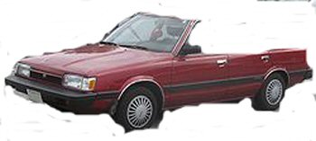

ivantruckman Posted March 3, 2009 Author Share Posted March 3, 2009 (edited) Nice, I like it. im gettin out the chainsaw zzzzzz my car wont look that good however Edited March 3, 2009 by ivantruckman Link to comment Share on other sites More sharing options...

abog Posted March 3, 2009 Share Posted March 3, 2009 Be prepared to substantially beef up the floor area. The roof of the unibody is a major support. Removing it will really weaken the structure. Link to comment Share on other sites More sharing options...
Pontiac6KSTEAWD Posted March 3, 2009 Share Posted March 3, 2009 All the cars pictured above will have steel reinforcements going from the front of the car, to the rear. I have seen 1 of those Verts, and the steel reinforcements hang down about 1 inch lower than the standard uni-body. I wouldn't suggest it without either beefing up the uni-body, or the car could buckle as soon as you hit a pothole/speedbump. Link to comment Share on other sites More sharing options...
