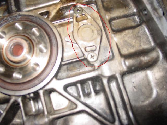

pearlm30 Posted March 12, 2009 Share Posted March 12, 2009 (edited) Ready to replace the plastic leaking seperator plate and there is this part next to crankshaft rear main and it just started to leak oil. What is this part? And how was it sealed(RTV, O ring or gasket):confused: Thanks Edited March 12, 2009 by pearlm30 Quote Link to comment Share on other sites More sharing options...
bheinen74 Posted March 12, 2009 Share Posted March 12, 2009 wrist pin access cover plate? Quote Link to comment Share on other sites More sharing options...
porcupine73 Posted March 12, 2009 Share Posted March 12, 2009 Hm looking at a diagram it looks like a part called 'service hole cover'. The diagram shows an o-ring behind that cover. Quote Link to comment Share on other sites More sharing options...
bheinen74 Posted March 12, 2009 Share Posted March 12, 2009 yeah i think it the svs hole to pull a piston out without splitting block. yep yep Quote Link to comment Share on other sites More sharing options...
Gloyale Posted March 12, 2009 Share Posted March 12, 2009 yeah i think it the svs hole to pull a piston out without splitting block.yep yep It's to pull the pistons TO split the block. Splitting the block really can't be done without removing the pistons. There is a way to cheat, and split the case, then unbolt the rods from the crank. But it is a PITA, and not how the engine was designed. Quote Link to comment Share on other sites More sharing options...

pearlm30 Posted March 22, 2009 Author Share Posted March 22, 2009 I spend an hour looking for the part number of this O ring @ subaruparts.com but I couldnt find it. Anyone knows the O ring part number? Thanks Hm looking at a diagram it looks like a part called 'service hole cover'. The diagram shows an o-ring behind that cover. Quote Link to comment Share on other sites More sharing options...
johnceggleston Posted March 22, 2009 Share Posted March 22, 2009 I spend an hour looking for the part number of this O ring @ subaruparts.com but I couldnt find it. Anyone knows the O ring part number?Thanks used on virtualy every engine subaru has made since 1993, and beyond. #8 806931020 http://opposedforces.com/parts/legacy/us_b11/type_6/engine/cylinder_block/illustration_1/ great parts look up site, bookmark it. Quote Link to comment Share on other sites More sharing options...
pearlm30 Posted March 22, 2009 Author Share Posted March 22, 2009 Thanks a lot!!! Quote Link to comment Share on other sites More sharing options...
