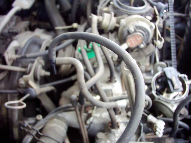

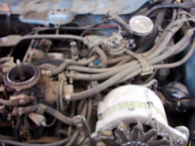

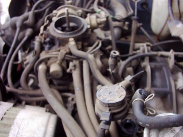

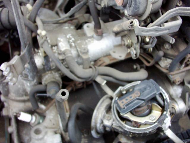

DR DLEX Posted March 20, 2009 Share Posted March 20, 2009 like this: or or or Link to comment Share on other sites More sharing options...
