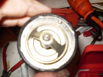

DavieGravy Posted May 15, 2009 Share Posted May 15, 2009 I've successfully replaced my water pump in my 91 legacy and the car runs fine. But there's a leak between where the thermostat housing meets the water pump. I can't figure out why. Does anyone know what the problem might be? I put the gasket intside the water pump first, put the thermostat over that then attached the thermostat housing. Link to comment Share on other sites More sharing options...
davebugs Posted May 15, 2009 Share Posted May 15, 2009 I'm not sure (can't recall). But on 95 and up the gasket goes AROUND the thermostat. Link to comment Share on other sites More sharing options...
johnceggleston Posted May 15, 2009 Share Posted May 15, 2009 I'm not sure (can't recall). But on 95 and up the gasket goes AROUND the thermostat. ditto Link to comment Share on other sites More sharing options...
DavieGravy Posted May 15, 2009 Author Share Posted May 15, 2009 ditto This is a 91 and I'm confused. Are you saying it goes like the attached picture? Also, I snapped one of the damn bolts that screws into the houseing and water pump. Where is the easiest place to find another one? Thanks Link to comment Share on other sites More sharing options...
johnceggleston Posted May 15, 2009 Share Posted May 15, 2009 Are you saying it goes like the attached picture? yes Link to comment Share on other sites More sharing options...

davebugs Posted May 15, 2009 Share Posted May 15, 2009 Yep - now you've got it. It really gets squished when you tighten the plastic snout. I can probably get you some bolts tomorrow - but by the time I'd mail them, etc the hardware store (or dealer) would be easier. I'm thinking they may have a coating to resist rust? Kinda look a little like brass(yellowish) but aren't brass. Link to comment Share on other sites More sharing options...
