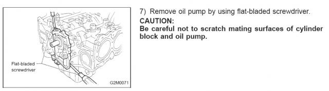

yohy Posted May 23, 2009 Share Posted May 23, 2009 The FSM for my "97 shows "flat-bladed" screwdriver in the removal step...although they do have the warning "Be careful not to scratch mating surfaces"--DUH!!. Link to comment Share on other sites More sharing options...
