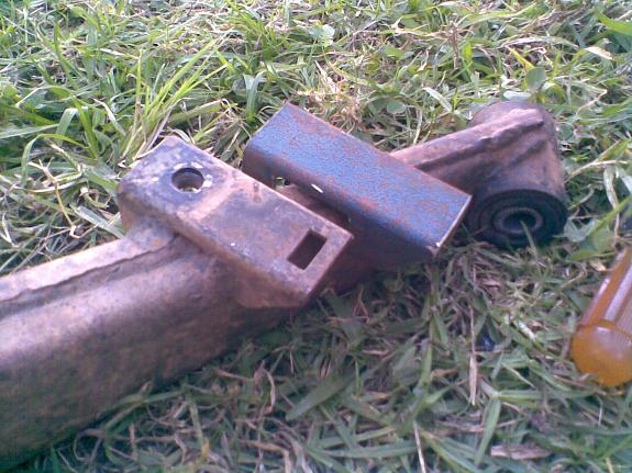

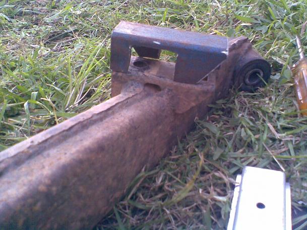

I am actually in the process of doing this myself.
The factory brackets are just 25mm rhs (1 inch box)
Ive already cut mine to shape, i just have to punch the holes in them, and weld them on
Im using some RX rear trailing arms to copy the brackets from
Here are some images of my progress so far
