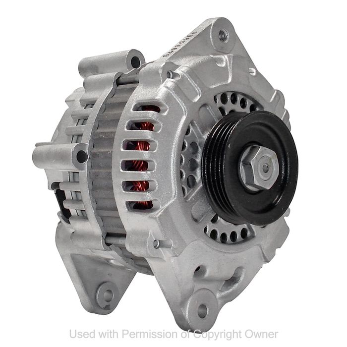

TheYeti Posted July 8, 2009 Share Posted July 8, 2009 So I was going to do this for the hatch over the past weekend after a successful visit to the PnP. I don't think the Maximom alternator is going to clear the Hitachi setup. This can only mean one thing: Weber. Link to comment Share on other sites More sharing options...
bheinen74 Posted July 8, 2009 Share Posted July 8, 2009 TheYeti said: So I was going to do this for the hatch over the past weekend after a successful visit to the PnP. I don't think the Maximom alternator is going to clear the Hitachi setup. This can only mean one thing: Weber. VERY GOOD INFO< THIS MOD WONT WORK WITH THe STOCK AIR CLEANER BOX/HITACHI.....the kidney bean thing is too large and in the way note to others...took 3 pages of threads for some real info. thanks TheYeti. Link to comment Share on other sites More sharing options...

Uncle Ed Posted July 9, 2009 Share Posted July 9, 2009 It WILL fit an EA81 with the stock carb and air cleaner. The only place it hits is the air cleaner bracket and you can grind or file the 1/8" off the ear to get the clearance needed to tighten the belt. This is the EA81 that I put in the wifes 87' EA82. Ed Link to comment Share on other sites More sharing options...
TheYeti Posted July 9, 2009 Share Posted July 9, 2009 Ed, can you clarify that one please? Are you saying the Maximom alternator will fit the Hitachi set up in an EA81/82, or are you saying the EA81 alternator will fit an EA82? Thanks. Link to comment Share on other sites More sharing options...
Psyko Posted July 9, 2009 Share Posted July 9, 2009 Looks/sounds like an EA82 gen wagon with a stock EA81 engine and a Maxima alternator. Link to comment Share on other sites More sharing options...
bheinen74 Posted July 9, 2009 Share Posted July 9, 2009 Psyko said: Looks/sounds like an EA82 gen wagon with a stock EA81 engine and a Maxima alternator. but what intake manifold on this ? that might be the problem. Link to comment Share on other sites More sharing options...
Psyko Posted July 9, 2009 Share Posted July 9, 2009 bheinen74 said: but what intake manifold on this ?that might be the problem. Uncle Ed said: It WILL fit an EA81 with the stock carb and air cleaner. EA81 perhaps? Link to comment Share on other sites More sharing options...
The Beast I Drive Posted July 9, 2009 Share Posted July 9, 2009 Ive seen Ed's car, and he has a stock EA81 with stock EA81 manifold on it, with a Maxima alternator and a home rigged power steering bracket. It all works quite nicely, he did mention having to grind/file down a little off the ear of the alt to clear the air cleaner... I myself am partial to the GM alt swap, I have a parts guy that gets em to me for less than cost, and it took about 15 minutes to mount it, using one of those chrome adjuster bars for a small block chevy that I offset just a bit. With the GM swap any autoparts store will have one in stock, they were the same unit from the 60's all the way to the late 80's. The Maxima swap is the perfect, bolt-in, minimal modification needed swap for the DIY'er, or the novice car-tinkerer lookin to upgrade his charging system. -Bill Link to comment Share on other sites More sharing options...

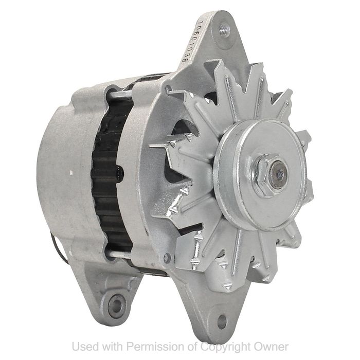

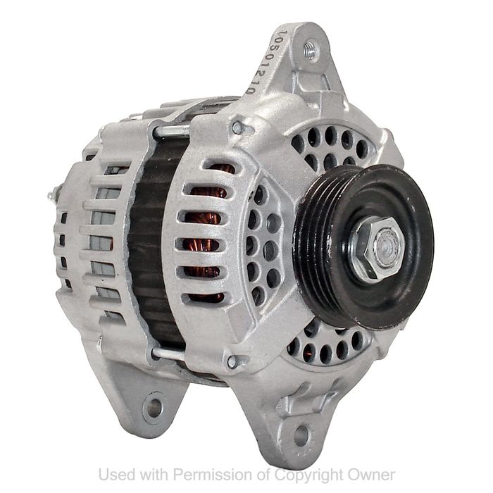

hardtail_pride Posted November 27, 2009 Share Posted November 27, 2009 Okay i just wanted to verify, this will also fit EA82 motors? Going to the JY tomorrow for a scavenger hunt. Link to comment Share on other sites More sharing options...
zukiru Posted November 27, 2009 Share Posted November 27, 2009 EA82t alt ea81t alt Maxima alt looks like a go to me! and thanks for the heads up GD! Link to comment Share on other sites More sharing options...
hardtail_pride Posted November 27, 2009 Share Posted November 27, 2009 Weird it shows the Ea82 motor with a serpentine belt pulley. Link to comment Share on other sites More sharing options...
GeneralDisorder Posted November 27, 2009 Author Share Posted November 27, 2009 hardtail_pride said: Weird it shows the Ea82 motor with a serpentine belt pulley. Yeah - that's not the right picture. I'm not sure what that goes to but it's not an EA82T. Might be an XT6 alt but even at that it doesn't look right. And just because it's got a multi-rib pulley does NOT mean it runs a serpentine belt. Multi-rib belts are generally *used* in serpentine applications but there are many applications that don't as well - look at the EJ22's for example - multi-rib yes - serpentine no. GD Link to comment Share on other sites More sharing options...
