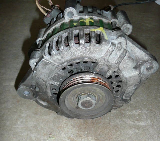

PadreScout Posted March 4, 2012 Share Posted March 4, 2012 Welp, I got a 94 Nissan Maxima alternator, built by duralast - part # 14661 at autozone. It doesnt fit, there's some bushing in the mount that wont fit into mah car. I would consider filing it to fit except the plug is wrong as well and well, this is looking bleak. pic of the offending part: in summery- the 94 year model alternator seems to be a no go. Link to comment Share on other sites More sharing options...
GeneralDisorder Posted March 4, 2012 Author Share Posted March 4, 2012 (edited) PadreScout said: in summery- the 94 year model alternator seems to be a no go. The bushing in your picture is a friction fit inside the ear. You can easily move it with a punch and a hammer. Flip it around if neccesary. All the listings I have seen say that '86 to '94 Maxima's use the same alt. Look on Rockauto.com for pictures and click on their part numbers for interchange info. The plug IS different. That's a given. You have to remove the plastic from the Subaru spade's and slip them onto the male spades of the Maxima alt. Or solder in the Maxima (also 95 to 98 Subaru) alt connector. And finally - Duralast makes GARBAGE parts. Return it and get a proper alt from Bosch, etc. GD Edited March 4, 2012 by GeneralDisorder Link to comment Share on other sites More sharing options...
PadreScout Posted March 4, 2012 Share Posted March 4, 2012 GeneralDisorder said: The bushing in your picture is a friction fit inside the ear. You can easily move it with a punch and a hammer. All the listings I have seen say that '86 to '94 Maxima's use the same alt. Look on Rockauto.com for pictures and click on their part numbers for interchange info. The plug IS different. That's a given. You have to remove the plastic from the Subaru spade's and slip them onto the male spades of the Maxima alt. Or solder in the Maxima (also 95 to 98 Subaru) alt connector. And finally - Duralast makes GARBAGE parts. Return it and get a proper alt from Bosch, etc. GD Copy that, I'll make it hapen, thanks for advice. On a side note the belts got to replace mine are wrong as well. the A/C, WP, .. something else belt is too short. Its fun times! I'll crack this baby yet. Link to comment Share on other sites More sharing options...
