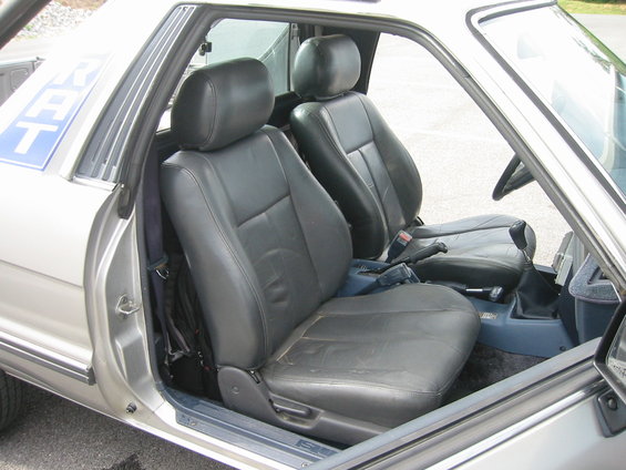

casm Posted August 4, 2009 Author Share Posted August 4, 2009 (edited) It's done, minus the heaters. On a quest for glycerine soap in order to clean them up a bit more - they've still got some junkyard dust on them in the photos. Click images for the larger versions. Edited August 5, 2009 by casm Link to comment Share on other sites More sharing options...
TheYeti Posted August 5, 2009 Share Posted August 5, 2009 They look really nice! I would like to do this for my hatch in the very near future. Nobody ever takes pictures of the mounts. Be a hero and post some pictures of the mounts... Link to comment Share on other sites More sharing options...
casm Posted August 5, 2009 Author Share Posted August 5, 2009 They look really nice! Thanks! I'm actually thrilled with the way they turned out - the old ones were great, but these are a major upgrade over them. Can't wait 'til the heaters are wired in. I would like to do this for my hatch in the very near future. Nobody ever takes pictures of the mounts. Be a hero and post some pictures of the mounts... Give me a day or two and I'll do exactly that I wish I could give you more info off the top of my head about them, but as I had a shop do the work it's pretty much an area I know squat about right now. Just remember these are the non-power seats - mounting power ones may be more difficult due to the motor positioning. Having said that, I highly recommend the swap - it just makes it that bit nicer to live with. Link to comment Share on other sites More sharing options...
