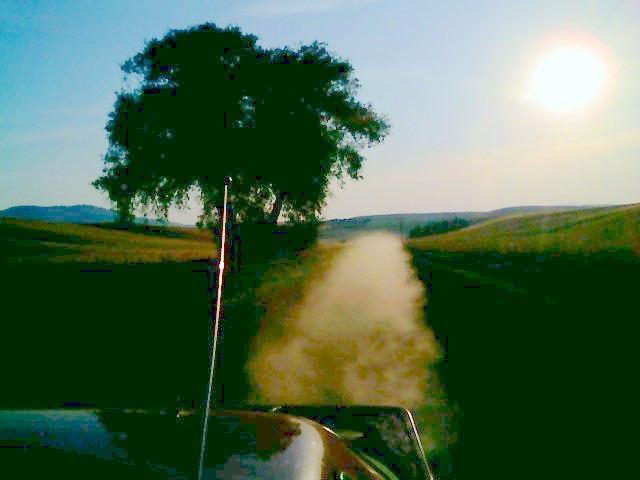

stuck my arm out the window with cell camera, doesn't really do it justice - freakin' cloud follows me for 20+ miles every day
had an idea this morning to add a lip to the underside of the top of the spoiler to kick some air down past the tail lights and see if the breaks the vacuum behind the car enough to keep the crap from coming back in the dead air zone and through the seals (as well as look into making an adjustment to the striker and latch of the hatch)
