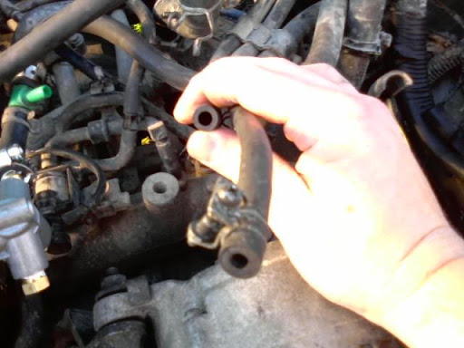

there are 2 vacuum hoses that are sticking out of the firewall on the drivers side. the outside diameter of them is both the same, one the interior diameter is different. which one is the fuel return line? and what is the other one for?

I cant remember locations exactly but one of those lines should be the return and the other is the tank vent (leave open). If you pulled the lines off the stock carb the fuel return should have been the smaller of the two that was hooked up right next to the main fuel line.
here are my options
the one on the left has a larger inner diameter and the one on the right has the smaller one
EDIT: i hooked up the small one to the fuel return
