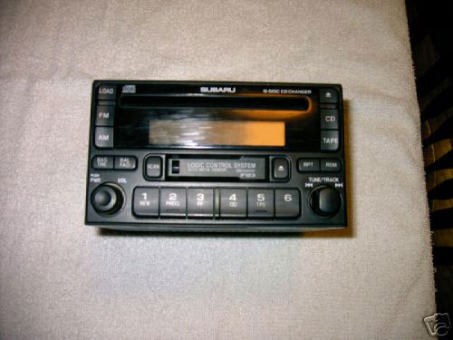

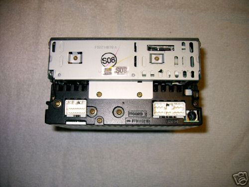

imprezaII Posted August 16, 2009 Author Share Posted August 16, 2009 Does any one have pictures that they could post here of the 2002 impreza CD/radio unit? . Found one on the internet, but wasn't very clear. Any help would be great........Thanks:) Link to comment Share on other sites More sharing options...
imprezaII Posted August 16, 2009 Author Share Posted August 16, 2009 Well, I found some pictures from the CD unit on the parts for subaru , so I think we have the pictures we need to compare the 2 units . Thanks........ Link to comment Share on other sites More sharing options...

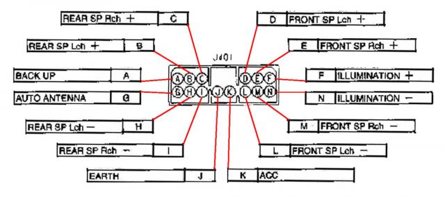

mentis Posted August 16, 2009 Share Posted August 16, 2009 Sure thing... and it just so happens I also have one of the wiring diagrams... (sorry the pics are low res though ) Link to comment Share on other sites More sharing options...
imprezaII Posted August 16, 2009 Author Share Posted August 16, 2009 Thanks Mentis, That is great. The pics are good . Now, I think when I get the hang of using this message board and researching want we need ,we will have the some of best info we can get, the hard part for me is not to get to impatient, and get only part of the info , so I have to read more, much more.... Thanks Link to comment Share on other sites More sharing options...

mentis Posted August 16, 2009 Share Posted August 16, 2009 No problem . I have this unit in my 87 wagon, but I just bought a 93 legacy. So I'll be wanting to do a swap, which I'm expecting to be a completely pain. I had to have the unit custom wired into my 87, so that's going to be tricky! Link to comment Share on other sites More sharing options...
mentis Posted August 18, 2009 Share Posted August 18, 2009 (edited) By the way, I just found an even better pinout for the 02 wrx unit! Someone on the NASIOC forums put this together, and did a great job too ... http://www.geocities.com/svxdc/WRX-pinout.htm EDIT: Incidentally, that guy also sells the harnesses for these units... http://www.geocities.com/svxdc/Ordering.htm Edited August 18, 2009 by mentis Link to comment Share on other sites More sharing options...
imprezaII Posted August 18, 2009 Author Share Posted August 18, 2009 Great info.. I recieved the CD /radio this morn, and just installed it, fit like a glove, excellent......Finally got the proper lug nuts to run my new to me dodge shadow gol colored snowflake rims and eagle RSA 1/2 good . Going for a ride with my wife to get ice cream .mmmmmm much appreciate the help on the wiring .:banana: Link to comment Share on other sites More sharing options...
