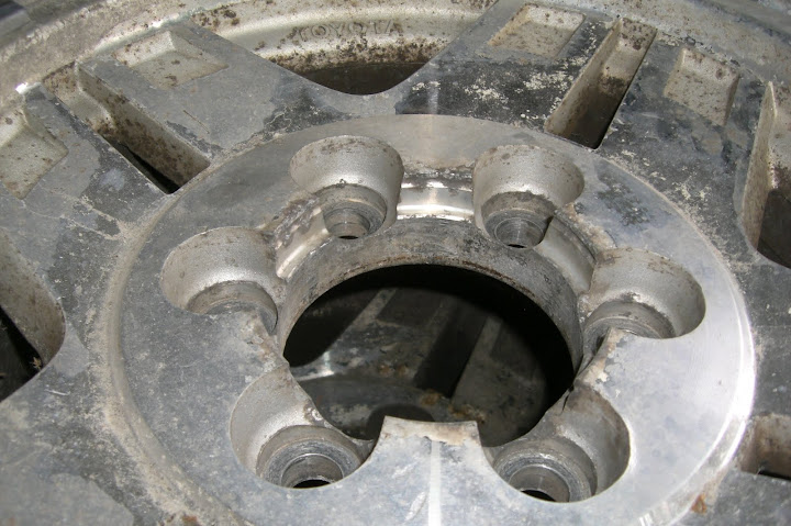

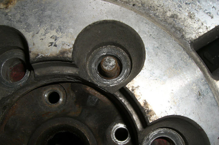

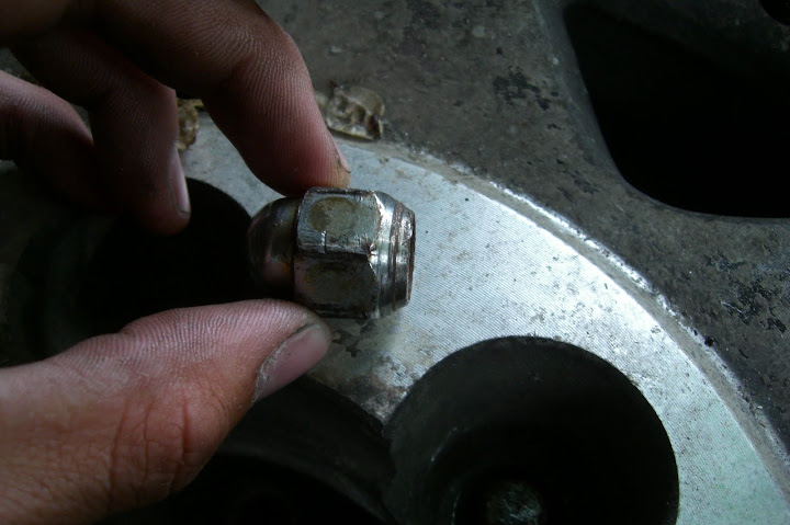

gwilson87 Posted August 5, 2009 Share Posted August 5, 2009 (edited) So new question here. These are my wheels I plan on using. (don't worry, i will clean them first) I am wondering if there will be problems with the thickness of the wheels and the size of the hole as seen here... currently I have these lugnuts with the chamfered edges ... and im wondering if i need to try and find toyota style lugnuts that part of them goes inside the wheel before seating like thus... If it so be that I need to use said toyota style lugnuts, Hopefully I can find some that thread onto my existing studs so i don't have to get all new lugs to match thread pitch Edited August 6, 2009 by gwilson87 added a photo. Quote Link to comment Share on other sites More sharing options...
The Beast I Drive Posted August 6, 2009 Share Posted August 6, 2009 You will need to use whatever lugs are supposed to be used on those alloys, using the tapered seat lugs on wheels that need Mag lugs is an absolute NO-NO. Shouldnt the Toyota thread pitch be the same as the Subaru studs? idk, It would just make sense to me, being as how they are both Japanese... -Bill Quote Link to comment Share on other sites More sharing options...
TheLoyale Posted August 6, 2009 Share Posted August 6, 2009 (edited) If thread "pitch" is thread type then I would say Toyota and Subaru stud threads might be diffrent. Subaru studs/Lugs are 12x1.25 dunno what Yodas run? Just my $0.02 -Tom Edited August 6, 2009 by TheLoyale Quote Link to comment Share on other sites More sharing options...
Numbchux Posted August 6, 2009 Share Posted August 6, 2009 I 100% guarantee that older toyota pickup lugs have a wider thread pitch than the subarus. subarus use a 12x1.25, and toyotas IIRC are 12x1.00 but you should be able to find some lug nuts with a "shank" style seat in a 12x1.25 pitch pretty easily. Quote Link to comment Share on other sites More sharing options...

gwilson87 Posted August 23, 2009 Share Posted August 23, 2009 I dunno if ninefourteener got it finished, I did find out that the thread pitch for the toyota these wheels cam from is 12x1.5. So I would either have to get all new studs or I found some the seat properly from autozone. Hopefully I can find some money to get new tires since all I have right now is 15" wheels, no rubber. Quote Link to comment Share on other sites More sharing options...
