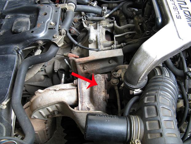

Here's what I discovered just now... I inspected the exhaust pipes while letting the car idle. Again, at first while engine's cold no noise. Slowly, the rattle starting coming in at a very low frequency (once or twice per minute maybe). Then it increased as the engine warmed up and got louder. I checked for broken welds as suggested above but found none, and checked for clearance etc. There seem to be no external parts coming into contact or shaking to make any such noise.
When listening closely, the noise does seem to be coming from the bell housing or the maybe the top of the exhaust pipe that attached to the engine/turbo. Sorry I don't know my terms well, but when I touched the top of that exhaust pipe I could actually feel the rattle the most. Don't know if that's transfer from elsewhere but it feels like it's coming from the inside of that... hope that sheds a little more light on this.

Cool... I'll keep that in mind. Not sure if it's the cat making the noise though. I got under the car while it was doing that, and listening in the vicinity of the cat, and I must say that the noise was not as audible in that area as it was directly above the engine.
Would there be any point to removing the exhaust from where it goes into the engine to inspect it? Or is that not a good idea :P...?
I'm attaching a photo of where it sounds like this might be coming from...
In your last picture, thats the turbo.
It could be some of the heat shields that surround it. Check to see if they are loose.
If the shields are tight and if your sure thats where the noise is coming from, you obviously need to replace the turbo.
I would remove the downpipe (the piece coming off the back that goes to the exhaust) and reach into the turbo and grab the little fan and see if you can wiggle it.
